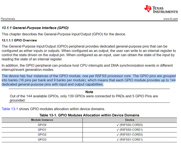

Hi Aman,
Apologies, I am not sure if I understand this correctly. The GPIO bank grouping is very simple as mentioned below from AM263Px Technical Reference Manual. Also, all the GPIOs can be accessed, operated and configured by all the 4 cores of R5F.
Do let me know if any other info is needed.
