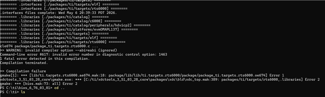

  • Hi Mukul,  Thank you so much. Just to update you, we tried building the sysbios-master code you sent link for and downloaded using attached bios.mk we configured for the OMAP-137/C6000. But it errors out as shown below but there were also no instructions that came with it for what combo of tools to use to build it. The download came with a ->packages->ti>bios directory, but the code in include header files were different then what is in 5_42_0_07 include header files of the same name.
    We also downloaded your latest version off of your website 6_76_03_28  (in case it was the version we had used to design this device that came with no code, but a later one would have the code) but  the install included no ->packages->ti>bios directory  and tried building with same make file for the OMAP137, but it fails also though in a different way but also no details on combo of tools used to get it to build. Same bios.mak. But installation there is no ->packages->ti>bios directory like there is in 5_42_0_07 directory so no lib and no include directory to interface with. Should a Bios directory be created upon installation or is it generated by the 'gmake -f bios.mak' command?
    The version we are using 5_42_0_07 has no build.mk or source files when we installed it (but it has a bios directory with the include header files). If would be helpful to get 5_42_0_07 with the source files and build.mk tree.
    The other versions like above you suggested came with build.mk ands source files  do not compile successfully for our OMAP137/C674 platform for the version of compiler and xdc tools we are using for 5_42_0_07 and one has no bios directory (where should the  ->packages->ti>bios have come from? generated somehow or should it have been part of installation?) and the other had bios directory but header file code interface is different then 5_42_0_07's (which is Ok if I have to update the application code to new APIs for functions, if it can build and work)
    We will wait to hear if you/team can just get us any building version that can run on OMAP-137/C674 DSP that we can demonstrate that builds for this hardware and works for this part to the FDA.(i.e., is there only a specific co'smbination of specific version of bios with specific version of xdc tools with specific  version of C6000 compiler that would result in a successful  'gmake -f bios.mak' command for the OMAP137/C674)  We cannot just show the FDA (Government) source code, we have to prove that it builds and we linked it into our CCS project, etc.  If your team located 5_52_0_07 with its source tree like the other ones and associated build.mk set up, that would be very helpful or any other combination that would work. Thank you again for your attention to this urgent matter for our company.
    bios.zip
  • Unfortunately have not been able to find any source tree for this or code base to share. This was legacy software and was not entirely shared in source to begin with. I will give it one more week - checking with some more internal folks, but low probability of finding this as of now.
