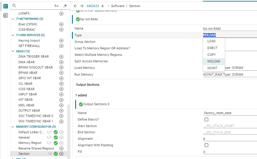

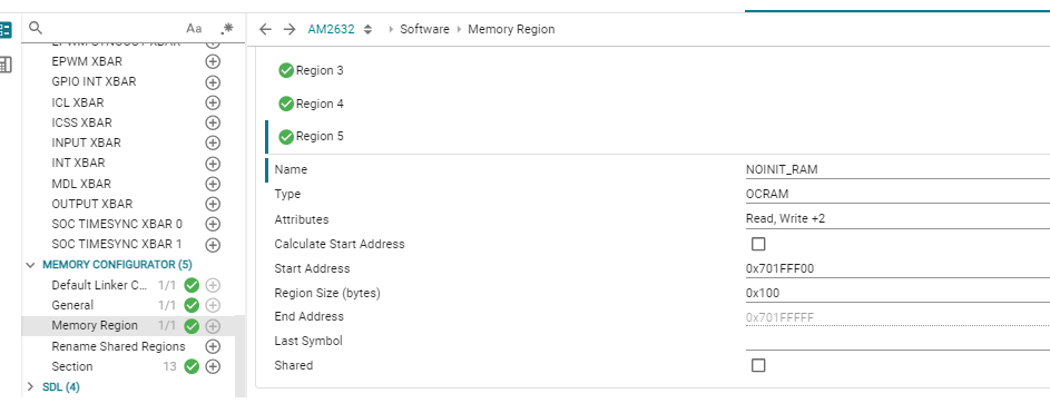

We need a no-init variable defined in RAM which not changed after a software reset.
Below pictrues are syscfg. Including region section and code. We set the section to 'NOLOAD'.
uint32_t u32_factory_reset __attribute__((aligned(8U))) __attribute__((section(".factory_reset_data")));
And we used SOC_generateSwWarmReset(); to reset MCU.
But the value of u32_factory_reset is always reset to 0 after sofware reset.

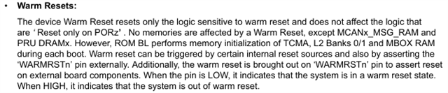

    L2 memory initialization is done by ROM code for banks 0 and 1, and the SBL performs the memory initialization on banks 2 and 3, which could be resetting the variable value.
    Also see the following excerpt present in the device TRM regarding this:

    But we used SOC_generateSwWarmReset(); to trigger warm reset in our code. and the memory 0x701FFF00 still be reset.

  • Hi Yao Wei,
    In your opinion, bank 0-3 will all be reset after ROM and SBL two processes in any PORz.
    ROM and SBL runs during every PORz and Warm Reset as well, and hence the memory initialization API " Bootloader_socInitL2MailBoxMemory();" called in the SBL is affecting the memory 0x701FFF00.
    If you really don't want the address to be affected across warm resets, then you should skip the memory initialization, which is not recommended as it is always necessary to perform memory initialization before using ECC-protected memory to avoid spurious ECC errors and potential system faults.
