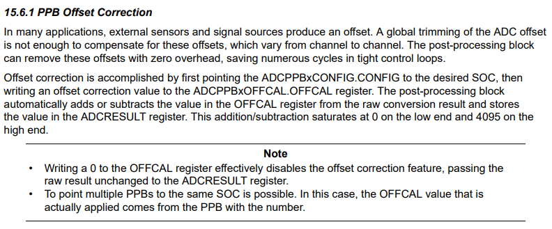

AM13E2X TRM RevA (REVISED MARCH 2026) describes a PPB feature -- Offset Correction in chapter "15.6.1 PPB Offset Correction":
However, mentioned fields in the registers are missing, as well as driverlib API. Is this chapter obsolete and functionality not available for AM13E2x?

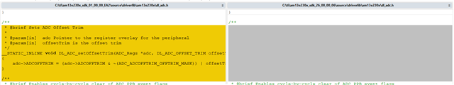

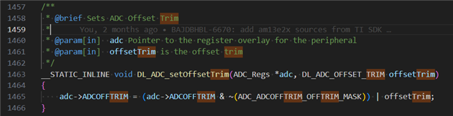

    We are an older version of SDK as of today -- 01.00.00.EA2.
    And driverlib on this version contains API to work with ADCOFFTRIM, e.g.:
    However, when comparing against 26.00.00.06 -- it seems that these functions were removed:
    Just an interesting observation, we are not using them, so it shouldn't be an issue for us.

    PPB Offset Correction (Section 15.6.1) operates on a per-SOC basis via the ADCPPBxOFFCAL.OFFCAL registers and is intended specifically for removing channel-level offsets introduced by external sensors or sources, with zero software overhead.
    After further review, I can confirm that this is a genuine inconsistency in the TRM. While Section 15.6.1 describes the PPB Offset Correction feature and the datasheet lists it as a supported PPB capability, the ADCPPBxOFFCAL register definitions appear to be missing from the TRM register map chapter, and the corresponding driverlib APIs are absent in SDK 26.00.00.06. I have escalated this internally to get clarification on the following:
