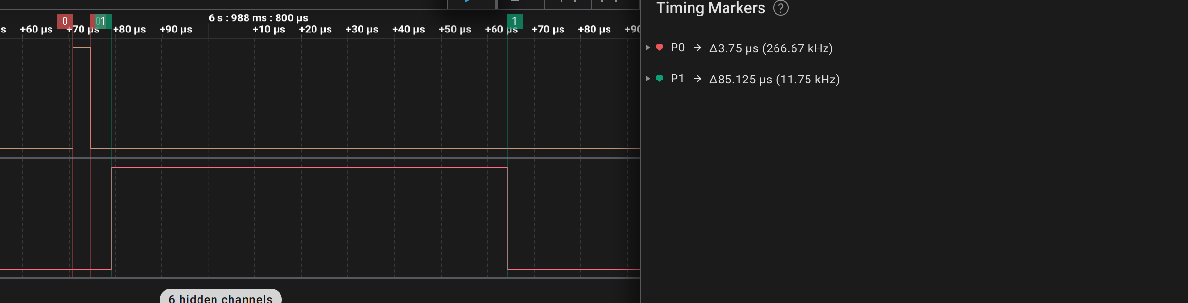

Dear Experts,
I am working on IPC communication between Core 1 and Core 0 of my AM261x-LP. I modified the example l2_enet_switch, in a way that Core 1 receive the packet and then send the packet to the Core 0. The communication works like this:
  1. Ethernet pkt is received from Core 1
  2. ISR is generated and semaphore is posted
  3. RX Task run and write the dequeued packet inside shared memory between Core 0 and Core 1
  4. Core 1 notify Core 0 (IPC Notify mechanism) that a new packet is received
  5. Core 0 wakes up and copy the packet from the shared ram inside its own RAM

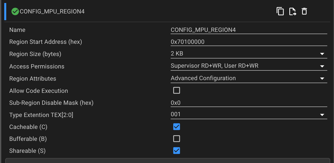

Every access of shared ram is protected by a spinlock. I read the post on shared ram, and my memory map is like this:
  1. OCRAM Bank 0: SBL + Core 0
  2. OCRAM Bank 1: CPPI desc + Core 1 (included the Enet DMA Packet Pool)
  3. OCRAM Bank 2: Shared Memory between Core 1 and Core 2. It is just a 2 KB region (for 1 full Etheret Packet), where the packet is copied to / from. The MPU is configured like this, both for Coresimage.png
The problem arise when I perform a memcpy in Core 0 and I am not managing to explain why: the memcpy takes exactly 85 us, against the 3.75 us of the Core 1.
The code snippet are:

I inspect the generated code and confirm that compiler is not optimizing memcpy by deleting it.
Any idea why Core 0 takes much long to copy data?

    Can you also share the example.syscfg files for the two cores so I could take a look at the memory configurator and MPU configs
    Shaunak
  • Sure, here you can find the syscfgs.
    I also made more tests, and actually it seems that memcpy is slow always (nothing related to IPC or Ethernet). I suspect some problems in MPUbut do not really know where to look

    mpu_armv75.$name        = "CONFIG_MPU_REGION4";
    mpu_armv75.allowExecute = false;
    mpu_armv75.size         = 11;
    mpu_armv75.isShareable  = true;
    mpu_armv75.isBufferable = false;
    mpu_armv75.baseAddr     = 0x70100000;
    mpu_armv75.attributes   = "NonCached";

    region1.memory_region[9].$name              = "ETH_PACKET_REGION";
    region1.memory_region[9].isShared           = true;
    region1.memory_region[9].shared_cores       = ["r5fss0-1"];
    region1.memory_region[9].size               = 0x800;
    region1.memory_region[9].auto               = false;
    region1.memory_region[9].manualStartAddress = 0x70100000;

  • Hi Elia,
    From initial analysis what i believe happens is, when you try to copy the ethPkt from 0x70100000, which is marked as non-cached and non-bufferable shared memory, where the destination memory is a cached OCRAM region (internalFrame).
    1. I believe the slow copy that we compare with fast copy is because we are reading from cache in one case and from a non-cached shared buffer in one case.
    2. Moreover, Non-Bufferable (isBufferable = false): The processor must wait for the write transaction to complete on the bus before proceeding. This is generally used for peripheral access where strict ordering is required. In this case, we set core-0 memory region to non-bufferable so it becomes slower as a result of no instruction pipe-lining.
    One solution you can try is to set the isBufferable = true (in both cores).
    Can you once try to rebuild the example and try to benchmark again and see if the above helps?
    Shaunak
    These are my results over 1k acquisistion
    MPU Configuration of Shared RAM Core 0 Latency [µs] Core 1 Latency [µs]
    Not Configured 23.44 ± 0.06 6.6 ± 0.11
    Shareable 86.86 ± 0.05 6.12 ± 0.11
    Cacheable, Shareable 86.86 ± 0.08 6.11 ± 0.1
    Cacheable, Shareable, Bufferable 86.86 ± 0.08 6.12 ± 0.15
    What is more surprising though, is that if I do the same copy (from shared memory region to Core specific OCRAM), I get this results:
    Not Configured 20.5 4.625
    Shareable 85.875 8.25
    Cacheable, Shareable 85.875 8.25
    Cacheable, Shareable, Bufferable 86 8.25
    So, from experiments, it seems that MPU is just messing around with Core 0 for some reason.
    Any suggestion on how to continue?
  • I found the main problem. One core was compiled with --use_memcpy=fast, while the other no. This results in an improvment of over 10x in speed.
  • Hi Elia,
    Thanks for the update, makes sense that --use_memcpy=fast created the improvement.
    Also, I am surprised that the bufferable = 0/1 did not create any change in performance.
    Shaunak
