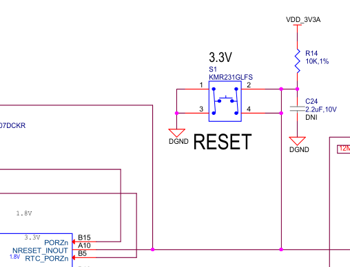

BACKGROUND:
My company makes a line of products that use a CPU board based on the Beagle Bone Black. Our board uses a AM3352 ARM processor. We're using an older version of Linux (V5.4) that was provided to us by TI.
PROBLEM:
I'm using the WARMRSTn signal from the AM3352 to reset a series of QUARTs. I've noticed that the WARMRSTn line is NOT asserted when I issue a "system("reboot")" command from my application program. The line is also not asserted when a watch dog timer is triggered.

    To better understand the watchdog side, could you please share the following:
    1. How are you triggering the watchdog?
    2. When the watchdog fires, does the board actually reset or does it hang?
    3. After a watchdog-triggered reboot, what does PRM_RSTST read?
    Harshith
    In linux terminal we enter the command “echo 1 > /dev/watchdog”
    1. When the watchdog fires, does the board actually reset or does it hang?
    Yes, the board resets. But we don’t see the WARMRSTn toggle.
    1. After a watchdog-triggered reboot, what does PRM_RSTST read?
    0x00000011

    We make a line of products that use a CPU board based on the Beagle Bone Black. Our board uses a AM3352 ARM processor.
    If you referenced the Beaglebone Black design, does your board have the CAP equivalent to C24 on BBB? If so, removing the CAP should resolve the RESETIN_OUTn pin toggle problem.
  • If you copied the BBB design, the CAP C30 should be removed too. Please just ensure there is no any CAP on the RESETIN_OUT pin.
