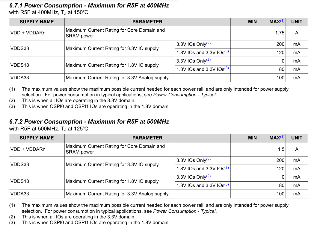

My customer want to know if system clock can be configurate to lower frequency while the device is running

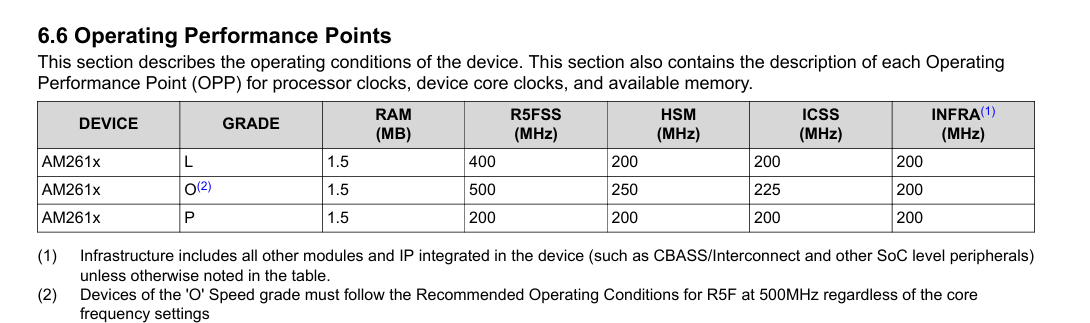

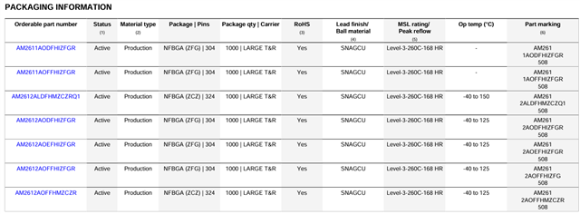

  1. Where can be find the device speed grade from marking? Do we have P speed grade device?
2. We just has the 400MHz/500MHz power assumption, do we have 200MHz power assumption?

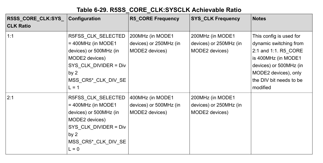

3. in trm, it shows it can be configurated to mode2(200MHz), is it can be changed while device is running in 500MHz? What's thing needed to pay attention to? What the sequence to change the frequency? What's may be affected when the frequency change? Is it can reduce the power assumption?
