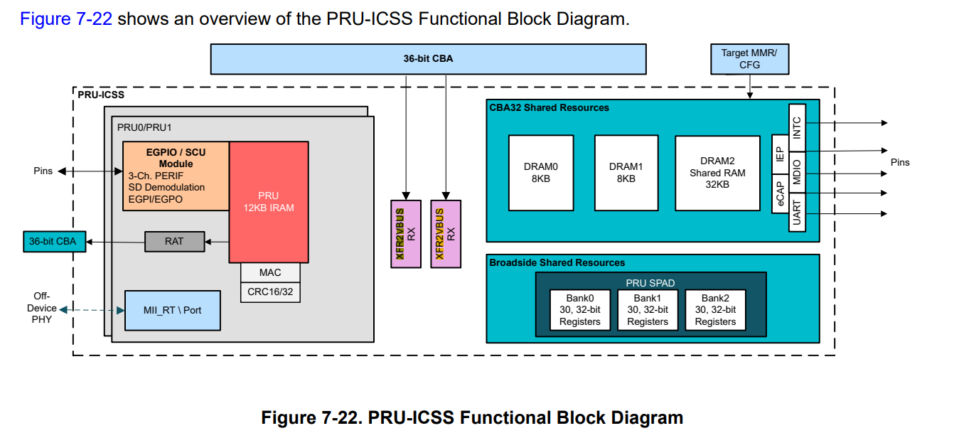

From the TRM, I gather that there are 2x RX XFR2VBUS accelerators and no TX accelerators in one ICSS instance (fig7-22 of sprujb6b):

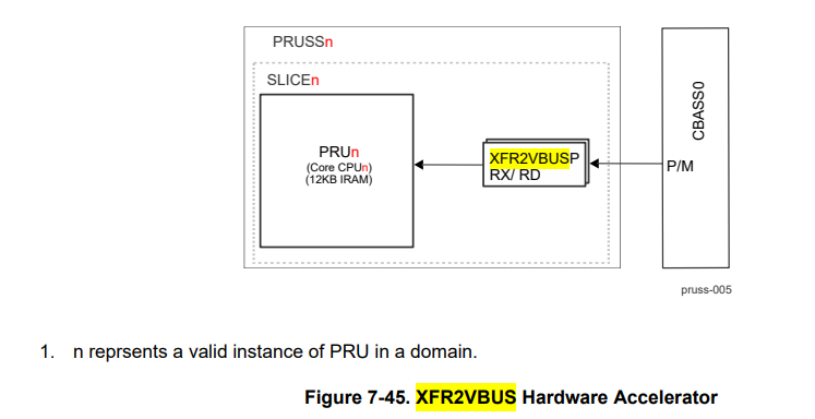

However, the text preceding this fig states that "There are two sets of XFR2VBUS for each Slice.", implying 4 XFR2VBUS in total. Fig7-45 also depicts the same - 2x RX accelerators per slice:

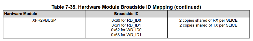

Additionally, table 7-35 lists broadside IDs (0x62, 0x63) for xfr2vbus TX accelerators:

  1. How many Rx instances are available in each instance?
  2. Are there any Tx instances?
