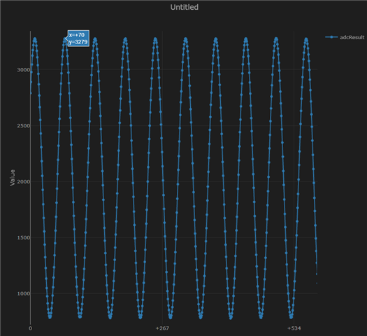

  • Hey Eric,
    I was able to get the Max frequency using the attached example.
    https://e2e.ti.com/cfs-file/__key/communityserver-discussions-components-files/908/hsadc_5F00_max_5F00_freq_5F00_dma.syscfg

    This isn't exactly specific to your use case but you can use this to build off of for best performance. The reason for this is the buffer is 32 bits wide but the results are just 16 bits so by using a sequencer at 9.4 MHz with the sequencer at switching between two SOC's tied to the same ADCIN0 pin. Hopefully this can get you started.

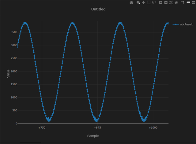

  • Thanks, Erik. With 2 SOC's both on ADCIN_0,sequencer end at SOC1, DMA in 32 bit width reading from ADCRESULT0, I see a slight increase with now ~2.84MSPS in continuous ping pong DMA-mode. Can you share your specific config/sysconfig file or setting that allowed you reach max frequency? Can I ask how you verified max frequency MSPS on your end? Did you derive from DMA buffer contents?

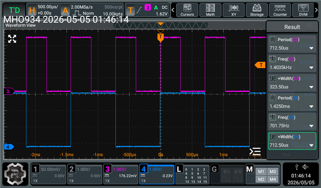

  • Attached is a screenshot of my scope. The pink trace is PA22 IO that I am toggling and represents the amount of time it takes for processing to finish. In my test function, I am just computing min/max and when the processing is complete we turn PA22 low. My ADC sample count is 2048.
    PB30 (blue trace) is toggled inside the DMA ISR. Once on early-IRQ (when the first half-buffer fills) and once on full-IRQ (when the second half fills). The square wave you see has period 1.42 ms with high/low width of 712 µs each, so each half-buffer arrives 712 µs after the previous one. I get my calculations by printing out over UART the halves processed in 500ms. I am consistently getting 694 halves processed every 500ms. So 694 halves/500ms  *  2048 samples/half = ~2.84MSPS. Let me know if there is something else you'd like to see.
    I will attach my adc.c driver and this is the test function used to measure adc/dma performance:
