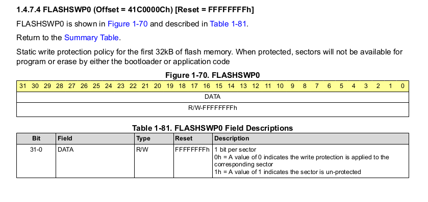

MSPM0G3519: FLASHSWP0 and FLASHSWP1 Clarification
Part Number: MSPM0G3519

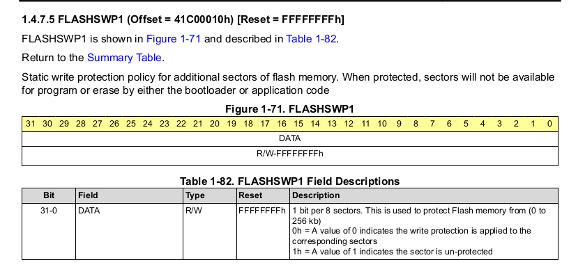

I have a 512 KB of flash with dual-bank support where each bank has 256 KB of MAIN. If FLASHSWP0 covers the lower 32 kB of the flash, then does the FLASHSWP1 cover the remaining 224 KB? If so, only the lower 28 bits are relevant? The description for FLASHSWP1 explcitly indicates it covers 0 to 256kb. If FLASHSWP0 is left at default value (unprotected), but if all bits for FLASHSWP1 are cleared (meaning all bits are 0), then it means the all of MAIN is protected, correct?
