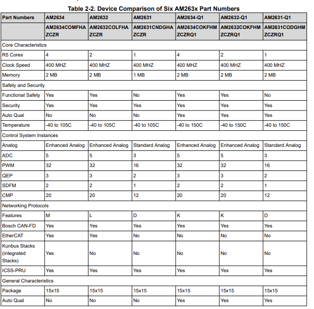

Does AM2632 feature code E support the EtherCAT Beckhoff SSC example for production use, or is the F variant required?
I believe all is needed is the EtherCAT hw accelerator to run the Beckhoff SSC as both master and slave, please help confirm.
