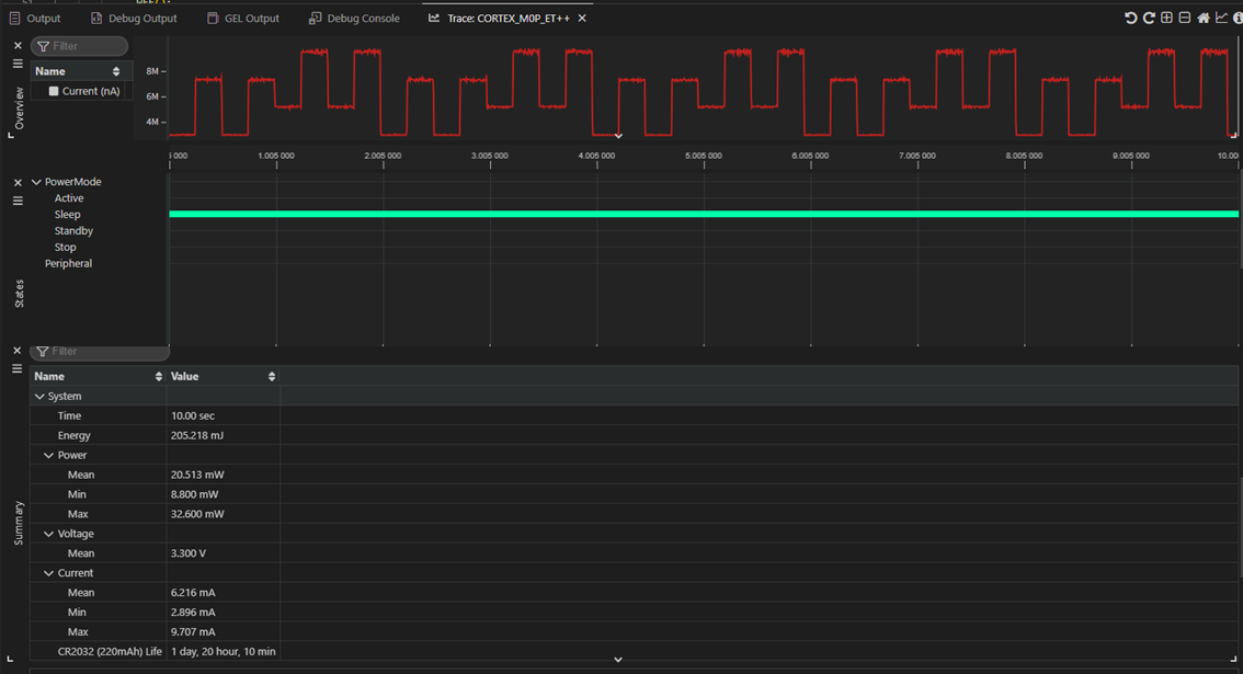

I unpopulated jumper on LunchPad and checked power consumption by using EnergyTrace.
Then, I got following result.

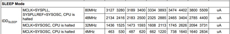

Even though state is "SLEEP", lowest power consuption is 2.896mA
From datasheet spec, I expect I can see half current of above. I confirmed all un-used pin is set as "output" with "low".
Do you have any idea why I can not get lower current ?
  • Hello Ryuuichi,
    It seems that you use CCS20 version and enter into debug mode to use Energytrace to see the power consumption, right?
    Firstly, when in debug mode, the power consumption will be abnormal. In other words, in debug mode, although from code level, MCU is in low power mode, but it is not real low power mode because debug mode maybe need CPU joined. I recommend you use CCS12 version energytrace which can be used in free run situation.
    Then please also check whether you have external circuit between VDD and VSS which will increase the power consumption. And check whether you leave any input GPIO as floating status. And check whether you add any pull-up / pull-down on your output low/ high GPIO.

    Thank you for your reply.
    Yes, I used "debug mode" as shown below.
    Yes, I also suspect this condition. (Measured current was similar to RUN mode which CPU is enabled)

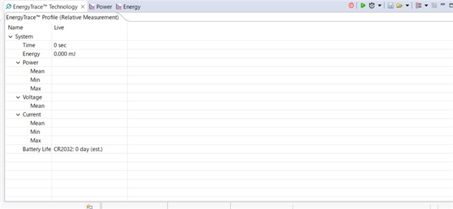

    I installed CCS12.8 and try to perform energytrace.
    However, I could not choose "energytrace++"(State is inactive) as shown below.
    Can I use "energytrace++" for MSPM0 on CCS12 ?
    Could you please give your feedback ?
    >Yes, CCS12 version Energy trace can be used for M0
    What I would like you to confirm is "EnergyTrace++" not "EnergyTrace".
    I also confirmed I could work "EnergyTrace" on my environment with CCS12. However I could not confirm power consumption by using "EnergyTrace++" on CCS12.
    Could you please reconfirm about this ?
  • Hello Ryuuichi,
    On CCS12 version, there is only "Energy Trace" and is not "Energy Trace ++". But for M0 power consumption evaluation, "energy trace" is enough.
