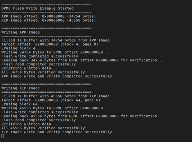

  • Hello Sajid/Winson,
    Please find below our latest status update regarding the GPMC application development and SBL integration.
    GPMC Application & Driver Integration :
    We have successfully completed the GPMC driver development, integrated it into the MCU+SDK, and thoroughly verified its functionality.
    • Implementation Details: We completed the necessary SysConfig changes for pin multiplexing (PinMux) to support the auto-generated code and finalized the GPMC driver implementation.
    • Validation: The driver has been tested many times almost 20K+. Read and write operations are stable and working exactly as expected.
    • Action Required: Kindly integrate the latest patches into your setup and confirm if the GPMC driver operates correctly in your environment.
    SBL Testing :
    We have successfully validated the boot flow using the following sequence:
    1. Flash Programming: The GPMC application image (Hello world) was programmed using the GPMC read/write Application.
    2. SBL Flashing: We utilized the UART Uniflash tool to send the GPMC SBL and flashed it onto the OSPI memory.
    3. Boot Execution: Upon a Power-On Reset  with the board configured in OSPI boot mode, the ROM bootloader successfully fetched the SBL GPMC from OSPI.
    4. Application Launch: The GPMC SBL successfully read the application image from the designated memory location and executed it from the On-Chip Memory (OCM).
    Next Steps & Ongoing Optimizations
    • DMA Enablement: I am currently implementing DMA support for read operations. Please note that DMA will not be enabled for write operations; because each word requires a 25us wait delay, utilizing DMA for writes provides no performance advantage.
    • Timing Parameters: The current timing parameters are stable. Mark is currently exploring further adjustments to optimize these parameters and maximize data throughput.
    If you encounter any issues while integrating these patches, please let us know.
    We are ready to assist you with any integration or debugging challenges.
    Patches :
    NOTE :  While configuring the Pin settings from the syscfg always check for the IOSET2 rather than IOSET1 .
    Anil.

  • I am attaching the new zip file, that has both the SBL tiimage I am using as well as the example that I use to write hello_world to gpmc.
    1057.sbl_gpmc.zip
    Please note that you need to have your hello_world written to 0x80000 offset if you are using this tiimage.
