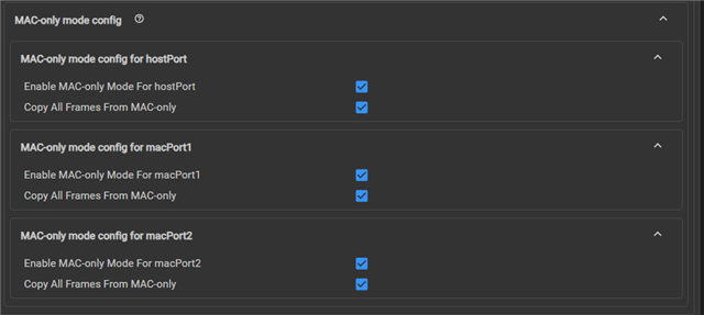

    I have updated the in the example syscfg file, as we are using the am261x_lp
    Still showing same clock issue
    .soc/am261x/soc_rcm.c:SOC_rcmGetModuleClkDivVal:1650: actOutFreq == outFreq failed !!!
    The team is working to get the 500MHz clock up. Meanwhile, Can you remove the CPTS clock from the config, if you are not using. For checking if the packets are coming out, you can either use wireshark or you can use stats by using gel files.
    Use debug mode and disable one of the macport from syscfg.
    I have did uncheck for CPTS:  CPTS TS Output in sys config
    Now able to ping
    But only if i connect both Ethernet port, if anyone is removed both will stop pinging.

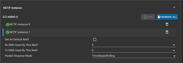

    I have enabled netif and mac mode attached reference

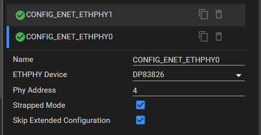

  • Hi Team,
    After reversing the PHY address mapping in the sysconfig
    we are able ping individual and also both together.

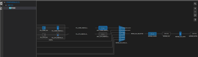

    Can please update on, how to fix the R5F running clock to   500MHz
  • SDK team is working on the permanent fix. Menawhile, you can follow this WA to get the clock to 500MHz
    Can you open your syscfg:
    1. Open the clock tree which on top-left side of the screen (the second one)
    2. Search for R5F, and open R5FSS0
    3. Check both the PLL_CORE and PLL_ETH divider values
    4. Check the final R5FSS0_CLKDIV value
    From the syscfg Clock tree values is 2.00gHz
    Even after changing the Divider to and R5FSS0_CLK to 500MHz in the clock tree
    same is not showing in the R5 Clock frequency as 500MHz
    Also the error is same as before :.soc/am261x/soc_rcm.c:SOC_rcmGetModuleClkDivVal:1650: actOutFreq == outFreq failed !!!
