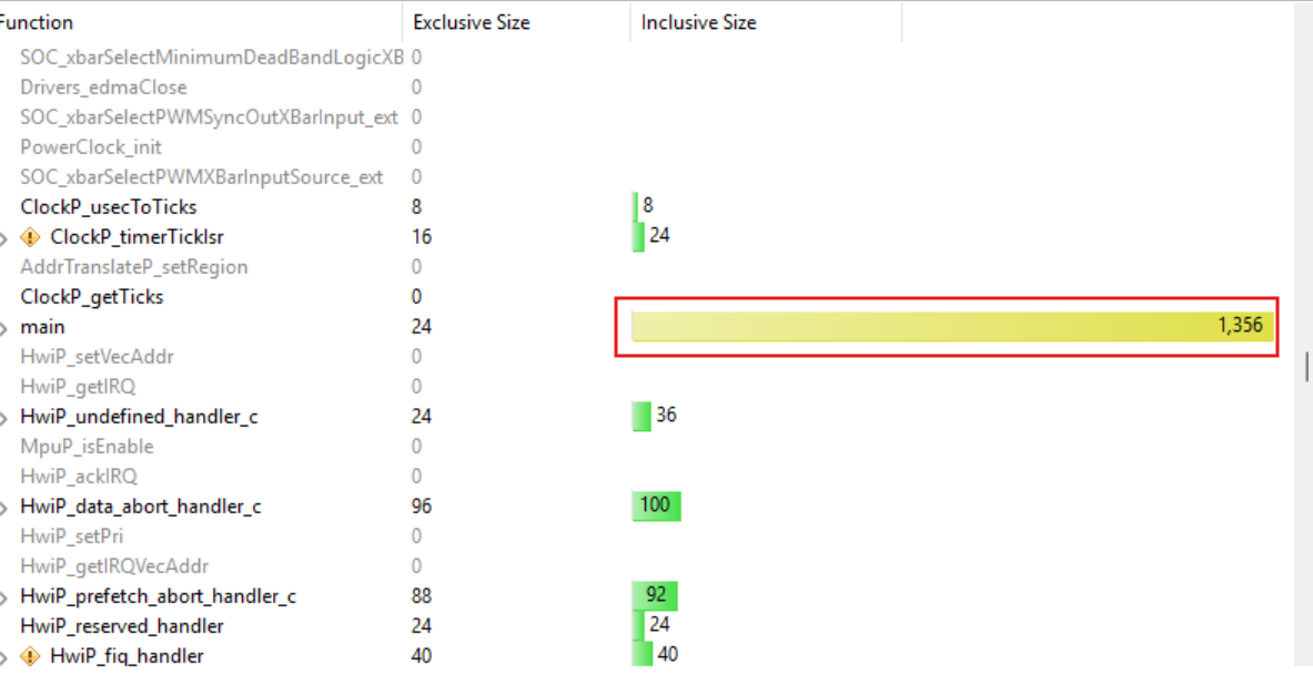

As part of the evaluation, I also want to analyse the auto‑generated code and project structure. To do this, I imported the auto‑generated CCS project into TI CCS 12.8.1. When reviewing the Stack Usage report, I noticed the following.
  • main() shows 100% usage
  • PWM ISR 146 shows 72% usage (Screenshots attached)
Pictures attached.
Questions:
  1. What is the unit of the “Inclusive Size” field in the Stack Usage view? It is not clear whether this value is in bytes or another unit. The CCS GUI does not appear to specify this, which makes interpretation difficult.

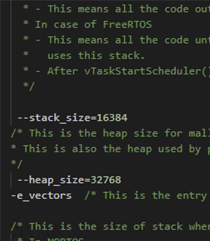

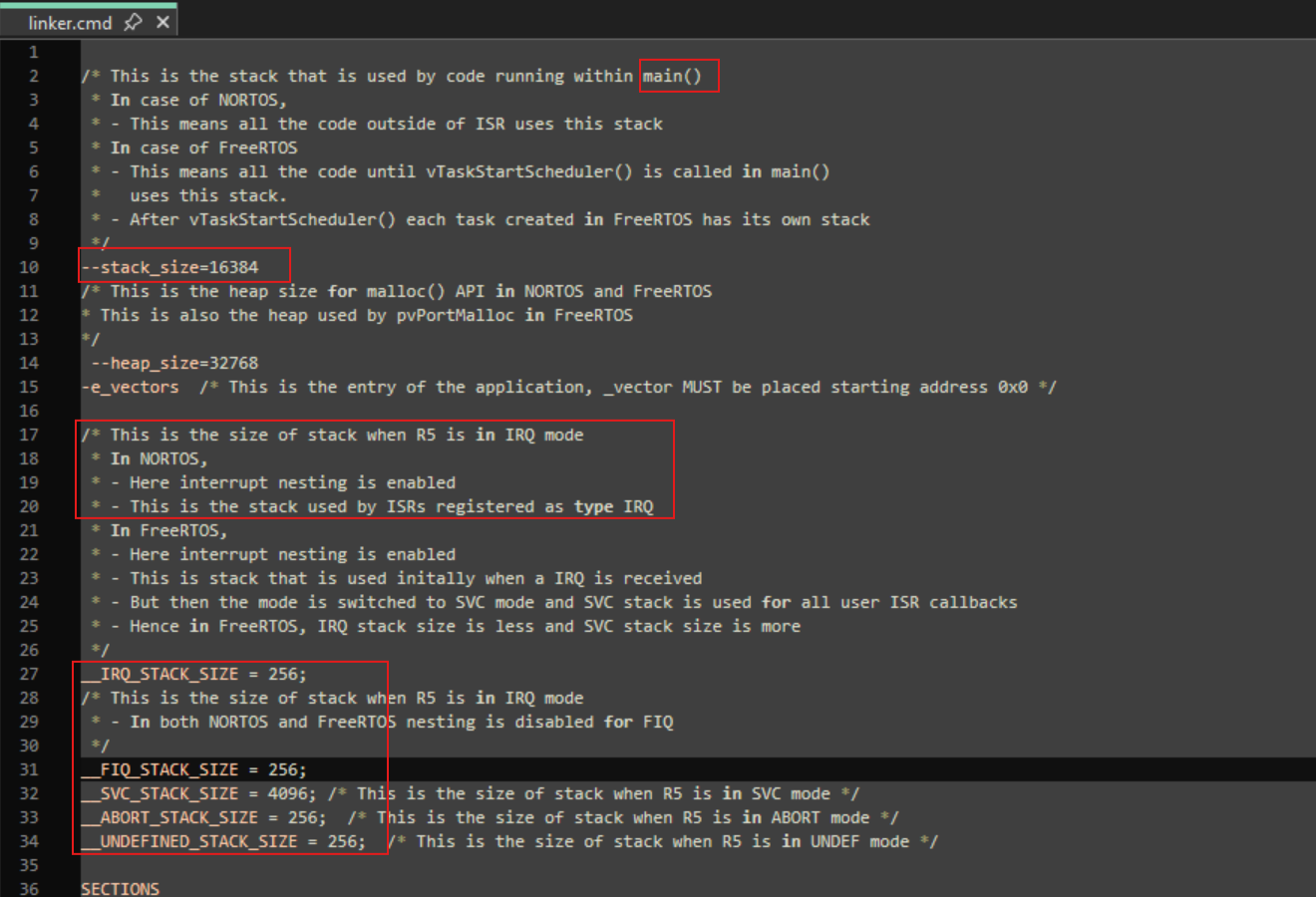

  2. How can the stack size be modified for the auto‑generated project? I attempted to change the stack size in the default linker command file located at: ..\am26x-hsp-PACKAGE_0014\toolchain\am263px\+matlabshared\+toolchain\+ti_arm_clang\linker.cmd   However, this did not appear to affect the stack‑usage calculation shown in CCS. (Screenshot attached)
