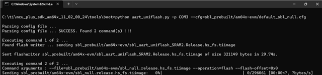

We tried to use uart_uniflash.py. but we are getting stuck in second stage .  cfg file used is default_sbl_null.cfg.
for your reference
C:\ti\mcu_plus_sdk_am64x_11_02_00_24\tools\boot>python uart_uniflash.py -p COM3 --cfg=sbl_prebuilt/am64x-evm/default_sbl_null.cfg
Parsing config file ...
Parsing config file ... SUCCESS. Found 2 command(s) !!!
Executing command 1 of 2 ...
Found flash writer ... sending sbl_prebuilt/am64x-evm/sbl_ospi.release.hs_fs.tiimage
Sent flashwriter sbl_prebuilt/am64x-evm/sbl_ospi.release.hs_fs.tiimage of size 325021 bytes in 29.77s.
Executing command 2 of 2 ...
Command arguments : --file=sbl_prebuilt/am64x-evm/sbl_null.release.hs_fs.tiimage --operation=flash --flash-offset=0x0
Sending sbl_prebuilt/am64x-evm/sbl_null.release.hs_fs.tiimage:   0%|                                  | 0/296061 [00:00<?, ?
Kindly guide us on this. Thank you for your support

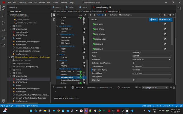

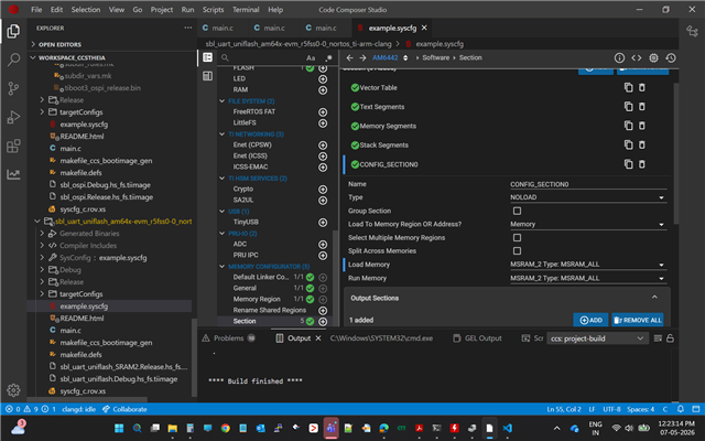

    For our application we plan to use OSPI and we dont have DDR populated so we were trying to modify the sbl ospi. kindly guide on next steps.
    Thank you.
    I assume you are using a custom board please confirm if that is not the case, if you are using a custom OSPI on your board then you would need to follow this guide to add support for the custom flash part in UART UNIFLASH: https://software-dl.ti.com/mcu-plus-sdk/esd/AM64X/12_00_00_27/exports/docs/api_guide_am64x/CUSTOM_FLASH_SUPPORT_GUIDE.html
    The default UNIFLASH uses a buffer placed in DDR to receive the image and then copy it to the flash later, as you don't have a DDR you need to make some changes in SBL UART UNIFLASH example and move this from DDR to MSRAM, you can follow the steps mentioned here:  RE: AM2431: AM2431 – UART Uniflash to OSPI Flashing Failure with HS-FS SBL on Custom Board

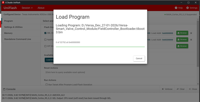

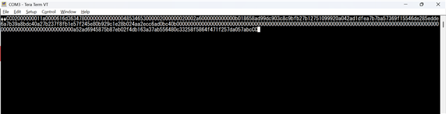

    We are using uart_uniflash.py with default_sbl_null.cfg. The flashing process gets stuck on the second command at 0%.
    As a workaround, we tried manually sending the image sbl_null.Release.hs_fs.tiimage from Tera Term using the XMODEM protocol after receiving continuous CCCC characters on the UART terminal.
    At one point, we were successfully able to send sbl_null.Release.hs_fs.tiimage once, but we were not able to send it a second time as mentioned in the flash diagnostics setup procedure from the forum thread.

    After this modification, we were able to enter debug mode through CCS using the flash diagnostic project:
    ospi_flash_diag_am64x-evm_r5fss0-0_nortos_ti-arm-clang

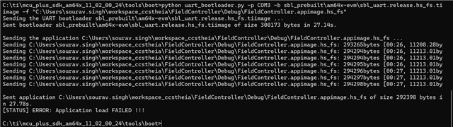

  • Hi, this is Sourav Singh.
    We executed the UART boot command from CMD using the compiled application image local path.
    Command used:
    python uart_bootloader.py -p COM3 -b sbl_prebuilt\am64x-evm\sbl_uart.release.hs_fs.tiimage -f "<appimage_path>"
    Observed output:
    • UART bootloader (sbl_uart.release.hs_fs.tiimage) was sent successfully.
    • Application image (ospi_flash_diag...appimage.hs_fs) was also transferred successfully.
    • Transfer completed without any communication interruption.
    However, after application transfer completion, the final status observed was:
    [STATUS] ERROR: Application load FAILED !!!
    This indicates that the image transmission over UART completed successfully, but the application failed during the load/boot stage on the target.

    We are trying to flash sbl_null.release.hs_fs.tiimage using the python UART uniflash utility with the below command:
    However, we are still observing the same behaviour where the first command in the .cfg executes successfully, but the second command gets stuck at 0% and no further flash operation happens.

    We also tested another example project:
    ospi_flash_io_am64x-evm_r5fss0-0_nortos_ti-arm-clang
    In debug mode, flash read/write/erase operations are working correctly there as well.
    So currently the issue seems specific to flashing through the UART uniflash python command only:
    where the second command in the .cfg gets stuck at 0%.

    Could you please suggest what could cause the UART uniflash flow to get stuck only during the second command, even though manual XMODEM loading and debug-mode flash operations are working correctly?
    In that case, you can skip the steps from the Custom Flash Support Guide and focus only on the SBL UART Uniflash buffer changes required for a no-DDR system.
    After making changes to the UART Uniflash example by following the above reply, have you rebuilt the example properly?
    Also can you share the example.syscfg file for the UART Uniflash example? I'd like to check the Flash and OSPI configurations of that example.

    Does your custom board have an eMMC?
    Meet.
  • No, we are only using R50 Core and OSPI boot mode supporting Uart fallback. DDR and eMMC are not populated/not used.
    Boot mode:-
    SW3 (0→7) : 1 1 0 0 1 1 1 0
    SW2 (8→15): 0 1 1 1 0 0 0 0
  • Then you need to remove MMCSD instance from your SBL UART UNIFLASH application's example.syscfg, please refer to the 4th point in this FAQ:  [FAQ] AM6XX:How to Port SBL UART UNIFLASH for a custom board
  • Hi !
    The UART uniflash command flow is working now after removing the MMCSD/eMMC instance from
    example.syscfg.
    However, when trying to connect using Uniflash GUI with XDS200 configured, we are getting the below error:
    Run failed...
    File Loader: Memory write failed: Timed out waiting for target to halt while executing am243x_alv_flasher.out
    Also, when we connect to the UART terminal and press reset, we are continuously receiving "CCCC" instead of booting sbl_null.
    Could you please suggest what could cause this issue in Uniflash GUI mode?
    It’s good to know that you successfully flashed the SBL NULL. Could you please switch to OSPI boot mode to run the SBL NULL
    Also, could you please check the tiboot3.bin you built for AM6421
    JOMY

  • Could you please suggest what could cause this issue in Uniflash GUI mode?
    Could you let me know why you are trying to flash the binary again with Uniflash GUI if flashing with UART UNIFLASH was already successful?
    This suggests that ROM was not able to boot the SBL binary from OSPI so it switched to the backup boot mode. Could you check if you are able to boot SBL NULL over UART or not? You can send sbl_null as the bootloader binary instead of sbl_uart: https://software-dl.ti.com/mcu-plus-sdk/esd/AM64X/12_00_00_27/exports/docs/api_guide_am64x/TOOLS_BOOT.html#UART_BOOTLOADER_PYTHON_SCRIPT
  • Hi Meet,
    We are able to manually load sbl_null.release.hs_fs.tiimage over XMODEM using TeraTerm, and it boots correctly in RAM. However, flashing through uart_uniflash.py with default_sbl_null.cfg still fails.
    We also tested uart_bootloader.py with sbl_uart.release.hs_fs.tiimage, where both bootloader and application transfer complete successfully, but it ends with:
    Since there is a ROM Boot failure, can you refer the Boot Failure section of the xSPI Debug Guide?
    Meanwhile, please give us some more time in investigating the issue.
