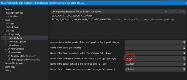

on AM263P4 device I tried to run prebuilt sbl and applicaiton, but it fails with the message below.
ERROR: Flash_norOspiOpen:1314: Flash_norOspiOpen : PHY enabling fail ed!!! Continuing without PHY... ERROR: Board_flashOpen:205: FLASH open failed for instance 0 !!! ASSERT: 0.27679s: ../main.c:main:111: status == SystemP_SUCCESS failed !!!

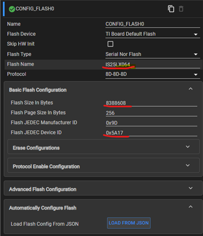

example code is based on IS25LX256 external but ZCZ-F device has IS25LX064. i think this difference and pinmap difference makes this issue. could you guide me how to build the SBL that works on the ZCZ-F?
now i'm using sbl_ospi_multicore_elf_am263px-lp_r5fss0-0_nortos_ti-arm-clang
Ted

    I changed sysconfig settings as below
    and changed device package to ZCZ-F
    Then OSPI gpios will show error, just suppressed it.
    and added an EEPROM
    and in project properties changed the package
    Then it works okay.
