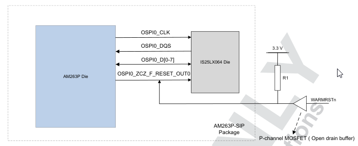

    J3 OSPI0_ZCZ_F_RESET_OUT0 pulled low
    J3 should not be pulled low. (This the the reset line to the SIP-Flash.)
    In AM263P-SIP device the J3 pin (RESET_OUT0 ) is an output from the AM263P4 that drives the flash reset line. It is an Active LOW signal - means pulling it low = puts flash in reset (disabled, unresponsive). Pulling it LOW externally forces the flash into permanent reset state, which explains the 0xFF status register read (no response from flash).

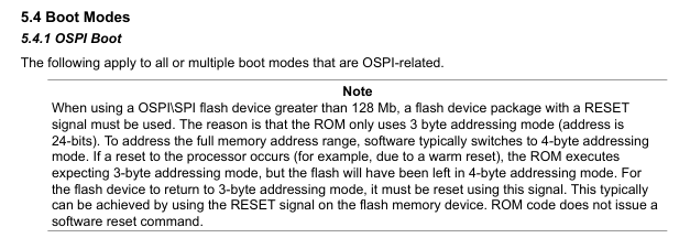

    • The ZCZ_F packages offers an internally connected on-die OSPI flash module (ISSI IS25LX064-JWLA3 OSPI Flash device). Due to the internal connections, the ZCZ_F package comes with additional pin connection requirements. Please reference Pin Connectivity Requirements in datasheet for pin connectivity requirements and ball names.
    • The OSPI_D2 signal of Flash die (pin L1-OSPI0_ZCZ_F_WP) doubles as the active low Write Protect input for the internally connected flash device. Therefore, pin L1-OSPI0_ZCZ_F_WP must be connected to the relevant source (VDDS33) through a separate 4.7kΩ external pull resistor. This resistor must be placed as close to the device as possible.
    • The OSPI_RESET_OUT0 signal of Flash die (pin J3-OSPI0_ZCZ_F_RESET_OUT0) must be connected to an open-drain equivalent of WARMRSTn in order to reset the on-die OSPI flash module. The open-drain requirement is to prevent a bus contention between the external WARMRSTn connection via pin J3-OSPI0_ZCZ_F_RESET_OUT0 and the package internal connection between the AM263P and the OSPI flash device.
    In Summary, there are 2 sources toi reset the flash
    1.  Warmreset Pin (Covering the internal and external warmreset sources) - this is done inorder to cover reruiremnt not in section 5.4.1 OSPI BOOT
    2. OSPI0_ZCZ_F_RESET_OUT0 - Reset signal to flash from the OSIP0_Controller (triggered using MMR configurations ) connected internally from AM263p die to Flash die inside SIP package
    Refer to Section 8.1.3 OSPI Connections for Flash-in-Package (ZCZ_F) in AM263P Datasheet for more details.

  • Rijohn,
    I see that I made a mistake in the original problem statement.  We compared the connection to J3 on our hardware vs the control card.  The circuit we use is the same as what is shown in the control card schematic page 14 OSPI Flash Reset.  The output of Q21 is high on the control card.  The equivalent transistor for our hardware is the same also high.
    I apologize for the confusion.
    Jeff
  • Rijohn,
    Your information was correct.  We were indeed driving the OSPI reset low.  The source for the error was using the schematic for the PROCA version of the control card.  This version of the schematic show an N-channel mosfet.  We discovered today that this was corrected in the PROCB version of the control card has this corrected.
    Thank you for the help.
    Jeff

  • Hi Jeffy,
    Sorry for the delay!!
    The source of confusion is that the PROCA board worked as expected.
    I get what you are saying, this was was mistake from our side. We initially made a mistake in keeping a nMOS instead of pMOS in the OSPI reset logic to J3 pin. PROCA version has Q21 (BSS138LT1G) which is an n-channel MOSFET in schematic. Causing the inversion operation of what is expected.
    Input (PORz) MOSFET State Output (OSPI_RSTn_R)
    LOW  OFF HIGH (3.3V) via R3878 pull-up
    HIGH  ON LOW (0V) pulled to DGND
    This error was caught during initial board testing itself and hence component was changed to pMOS, rotated and flipped(in Z-axis) to attain the needed functionality of the buffer as in the image below.
    Sincere apologies for the confusion caused.
