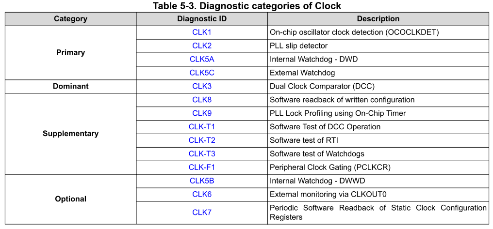

I am referring to the AM263P4 Safety Manual, where multiple diagnostic methods/mechanisms are listed theoretically (for example in the diagnostic tables with diagnostic method IDs and coverage information).
I would like to know if there are any SDK-level support/examples to implement these diagnostic methods practically.
I also referred to the following E2E thread:
 https://e2e.ti.com/support/microcontrollers/arm-based-microcontrollers-group/arm-based-microcontrollers/f/arm-based-microcontrollers-forum/1590246/am263p4-q1-error-detection-fault-injection-methods-described-in-the-functional-safety-manual/6142811?tisearch=e2e-sitesearch&keymatch=SDL_AM263px_diagnostic_mapping
In that discussion, an Excel sheet related to diagnostic mapping in the SDK was mentioned. However, I could not locate the referenced SDK package,
Could you please help clarify:
Where the mapping between Safety Manual diagnostic IDs and SDK APIs/examples is available.
Whether any example projects or fault-injection demonstrations are available for AM263P4.

  • Hi Sravanthi,
    You can request it from below link:
    Secure resources | TI.com
    First i would suggest you to download CSP package and refer the diagnostic mapping excel that will clarify the how to implement most of these safety mechanisms.
    Thanks & regards,
    Jagadish.
