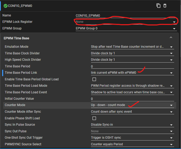

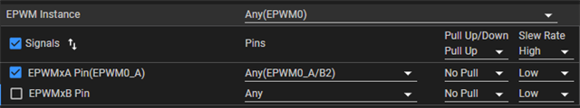

  • Hi Masoud,
    I have done the configurations in Sysconfg for enabling the ePWM instance. I configured in Time Base and attached the screenshots, which I enabled. If anything is missed, please let me know.

  • Hi Rajkumar,
    The SysConfig settings you shared look fine for adding/configuring the EPWM instance. Can you confirm the SysConfig generated initialization code is actually called? For SysConfig-based bare-metal projects, the generated clock/pinmux/peripheral initialization is applied only when the generated init functions are called from the application. For example:
    System_init();
    Board_init();
    Drivers_open();
    Board_driversOpen();
    From the screenshot, the Time Base Period is set to 0. Even if the EPWM clock is enabled, you will not get a meaningful PWM waveform with TBPRD = 0. Please set a non-zero period value, and also configure CMPA/CMPB and Action Qualifier settings if you want to observe EPWM output on the pin.
    If the register still does not retain the value, it usually means either the CONTROLSS registers are still locked, the generated initialization is not being called, or another part of the code is disabling TBCLK again.
    I would suggest starting from an existing AM263Px SDK EPWM example, enable EPWM0 in SysConfig, and then compare the generated files and application init sequence with your bare-metal project.
