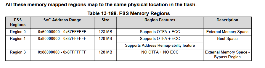

I am trying to extend the OSPI-SBL to be able to receive data via CAN and write that data to flash, specifically I want to be able to write a mcelf file to update my firmware.
Some things are still unclear to me, please help me clarify a few things.
  1. What is the difference between 0x80000000 address space and 0x60000000? Both seem to return the same values, when I read these with UniFlash.
    The external flash is memory mapped to 3 SoC address spaces. 0x6000_0000, 0x8000_0000 and 0x8800_0000. These regions serve 3 different purposes.
    Please see the below excerpt from TRM
    If AB swap (flash remap feature ) is not used. Then 0x6000_0000 and 0x8000_0000 address is the same functionally.
