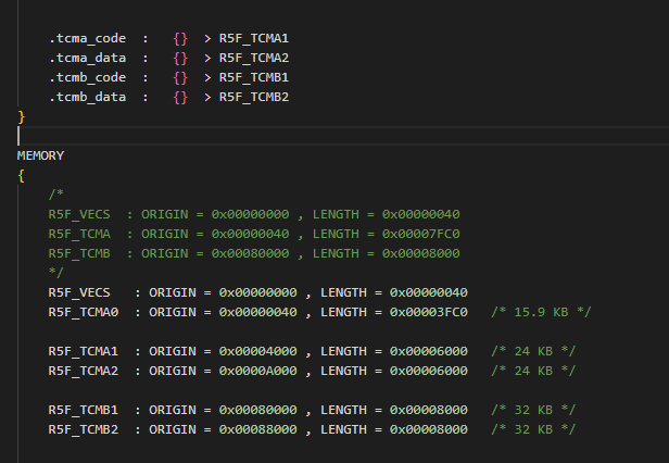

Hi TI,
I am running a multicore project where core0 is run in lockstep mode. Below is my TCM memory assignments and sections from the linker.cmd file. Initially I was not using .tcmb_data memory region and I was able to enter into debug session from CCS. However, recently, I have added some variables to .tcmb_data region after which I am not able to enter debug session from CCS as it throws below error.
Could you please let me know how to resolve this issue as debugging from CCS is imporant to our project to run tests during development phase. And I don't see anything wrong with the TCM region memory assignment and usage.
Thanks in advance!
Cortex_R5_0: Trouble Writing Memory Block at 0x88000 on Page 0 of Length 0x440: (Error -1065 @ 0x0) Unable to access device memory. Verify that the memory address is in valid memory. If error persists, confirm configuration, power-cycle board, and/or try more reliable JTAG settings (e.g. lower TCLK). (Emulation package 20.5.0.3902)
Cortex_R5_0: File Loader: Verification failed: Target failed to write 0x00088000
Cortex_R5_0: GEL: File: C:\Users\ab123\workspace_ccstheia\AM263x_CORTEX_R5_0\Debug\AM263x_CORTEX_R5_0.out: Load failed.
