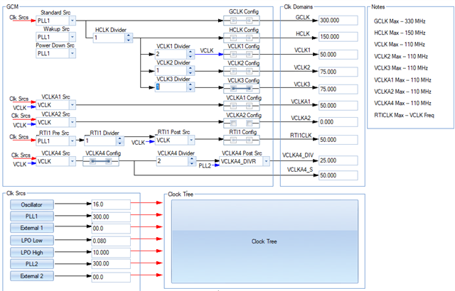

I am tryingto get ethernet workoing on the board and part of that is configuring ECLK to output a 50MHz signal (am using RMII mode). To get 50MHz I have to change the VCLK1 divider to 2, halcogen shows an output frequency of 50MHz.
This clock is also used by the SCIs, all of these SCIs work fine before i change the VCLK divider, after I change it the UART baudrate as measured with a logic analyzer doesnt make sense. Instead of 115200, im measuring 173670. What is interesting is that this baud would make sense if a  clock of 75MHz had been divided with the values halcogen calculates for a 50MHz clock to hit 115200.
This makes me think that VCLK1 is not actually getting changed to the frequency i am setting in halcogen, that said I have had difficulty confirming as my attempts to measure the frequency have not suceeded.
I have found no help in the forums, so any thoughts would be appreciated.
Here is the GCM tab
Here is the SCI config showing the prescaler value
Here is the logic analyzer capture
Danilo
  • This is my question, here is the GCM window
    Curiously, if I change the HCLK divider to 0 then the VCLK dividers to hit their original frequencies I don't seem to have this issue and UART works again...

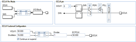

    I think the issue lies on clock settings only because i also did route VCLK1 to ECLK and verified frequency and found your setting generating 75Mhz only not 50MHz.
    And i verified divider register as well and it is correctly configured, which is 2 for 50Mhz from 150Mhz of HCLK.

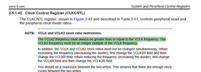

    Then i found we are not meeting below criteria with your configuration, because VLCK(VCLK1) and VCLK2 are not integer multiples.

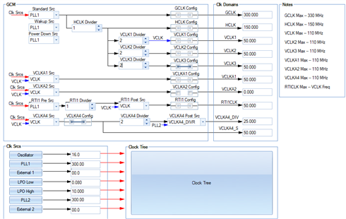

    And i modified settings as below to meet above criteria:
    However, this is also not helping here and still i can only see 75Mhz. I tested on RM57x board as i don't have TMS570LC4357, could you try with above settings once at your end let me know.

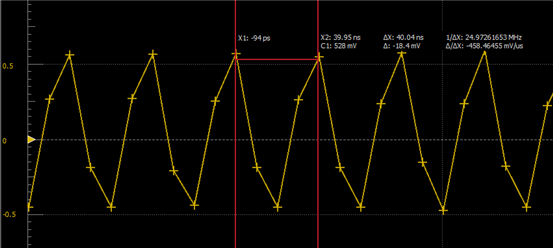

  • Apologies for the late reply, Here is what I'm seeing on the ECLK output with those settings.
    Here is a scope capture of the ECLK output with those settings
    Additionally, UART is nonsense
    Then back with these settings:

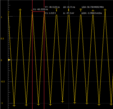

    ECLK capture again...
    My scope can only run at 100MHz, but the capture confirms its very close if not exactly 50MHz.
    And finally, UART works
