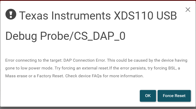

2.using CCR20.5.0 to flash flash_bsl.out to the device
3.encountered the following error:“Flash Programmer Error: Attempting NONMAIN write without erasing.”

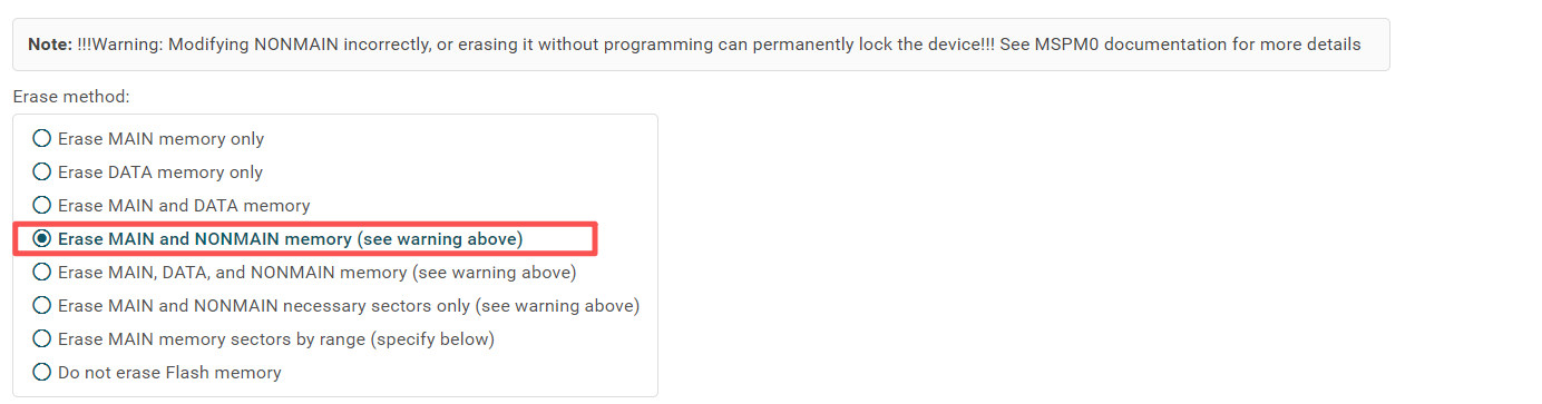

4.To recover, I re-flashed a full application image via UniFlash using the configuration shown in the attached screenshot.
5.The loading process appeared to complete successfully with no errors reported.
  But M0C1104 cannot detect any I2C devices. It seems M0C1104 cannot work normally.

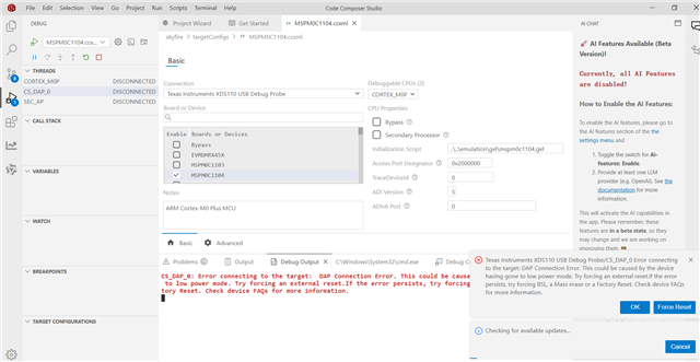

6.However, since that operation, the device no longer accepts any new firmware uploads — every subsequent attempt fails instantly with the error below:
Is there a way to recover the device? Any guidance would be greatly appreciated!
