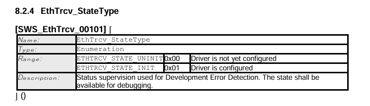

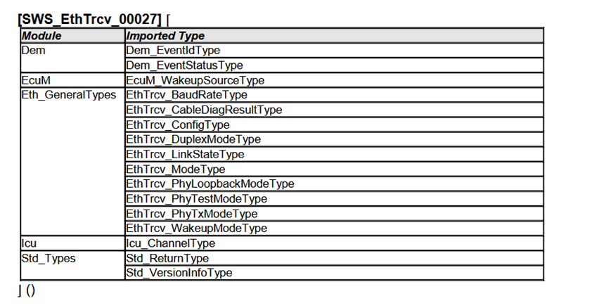

As per AUTOSAR Specification EthTrcv_StateType implementation should be part of Eth_GeneralTypes.h, but implemented in EthTrcv_Types.h.
Could you please provide your feedback on this?
