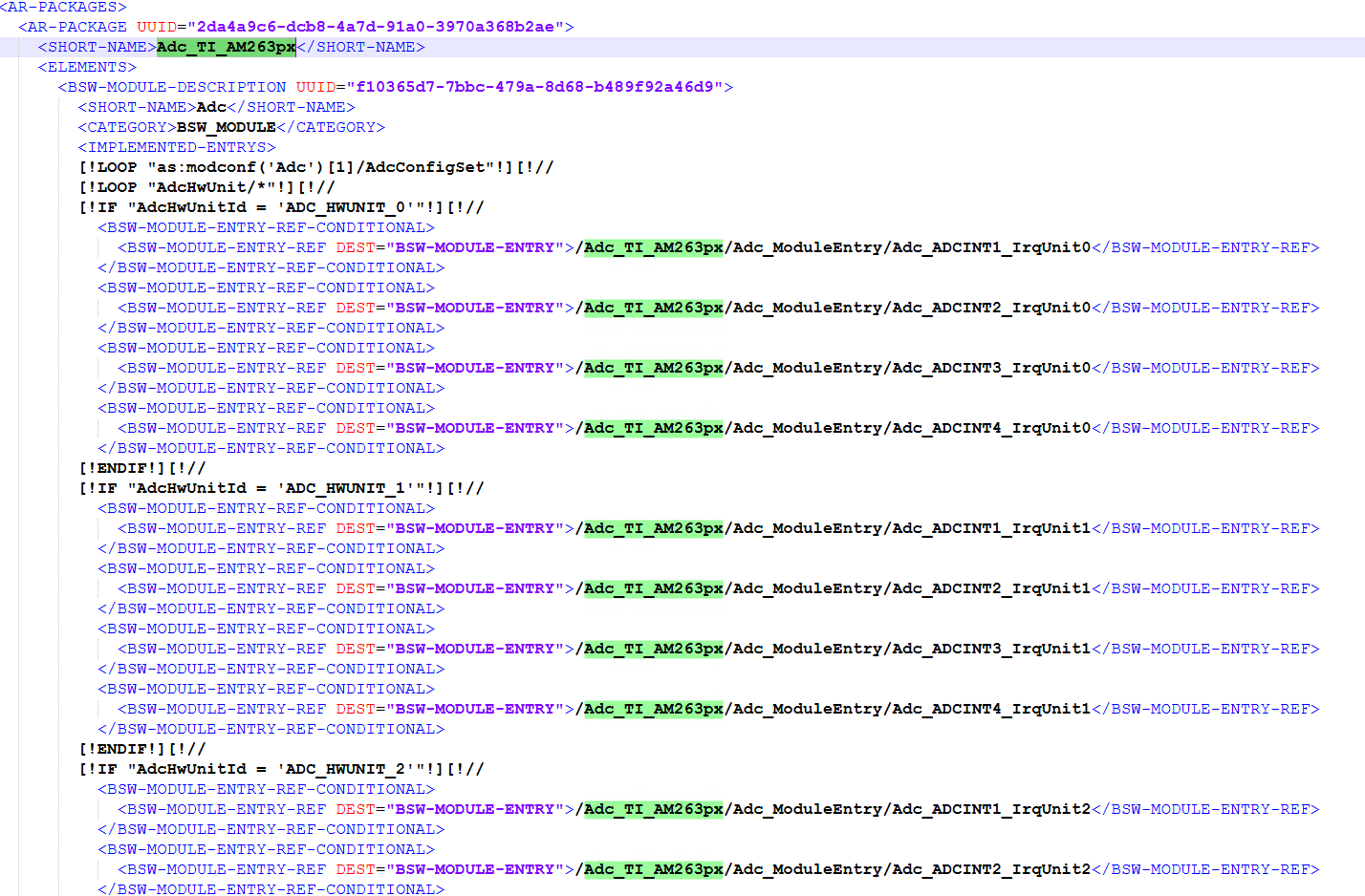

In bswmd arxml file for All MCAL Modules the Naming convention which is used for Module Name is not same as the Plugin and plugin.xml and because of this Case Sensitivity we are getting compilation issues.
If we take Adc as an example:
In the Bswmd arxml file it is Mentioned as Adc_TI_AM263px

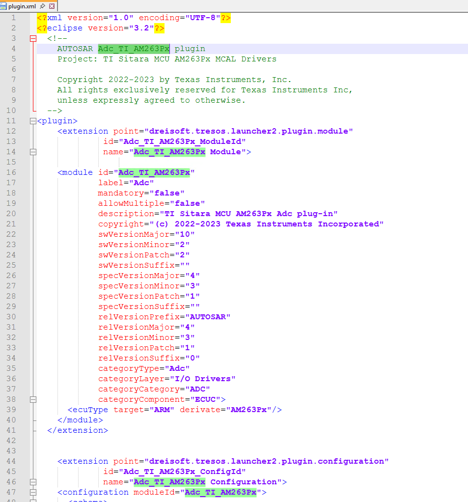

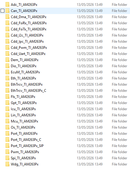

In Plugins Folder and in the Plugin.xml file of the Module it is Mentioned as Adc_TI_AM263Px
Can you please check this issue and provide your feedback
