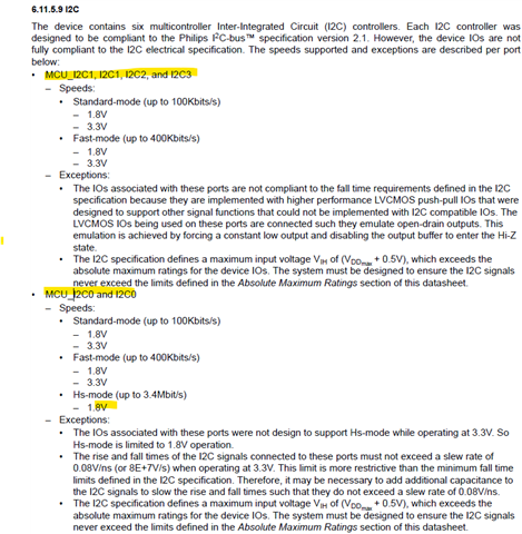

In our application, we are facing the issue while I2C is configured above 1Mhz.
While configuring I2C for 1MHz and above there some ringing/pulses observed on I2C_SCL line.
Moreover these ringing were not observed when I2C is configured for 100kHz or 400kHz.
Can you provide your feedback on the same what why these pulses are observing above/ for 1Mhz?
It's hard for us to analyse that does it is a software bug or Hardware bug.
Kindly response on the same.
