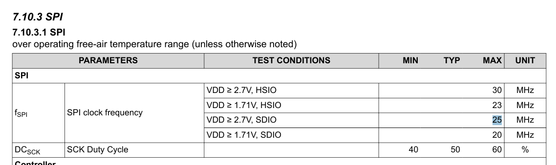

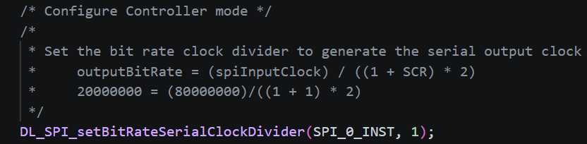

According to slasfb6 , shows that the SPI can reach 25 MHz as below.

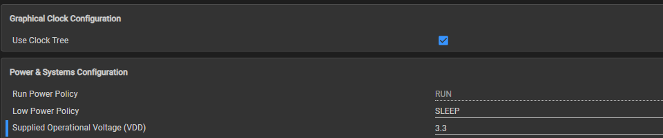

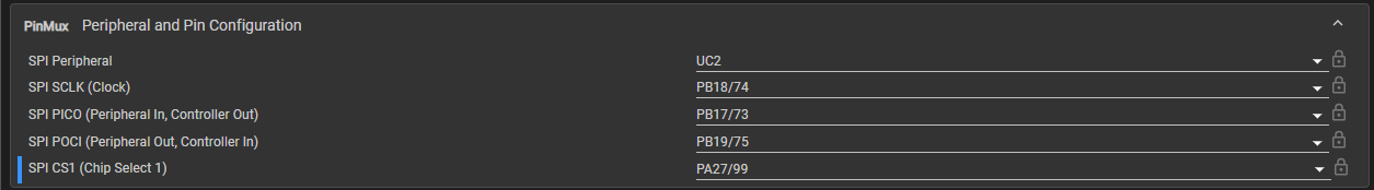

I have configured the SPI pins under UC2 which is SDIO , and the VDD = 3.3 V according the table above.

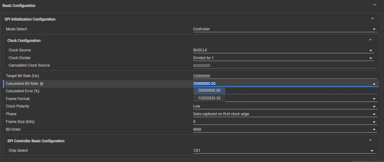

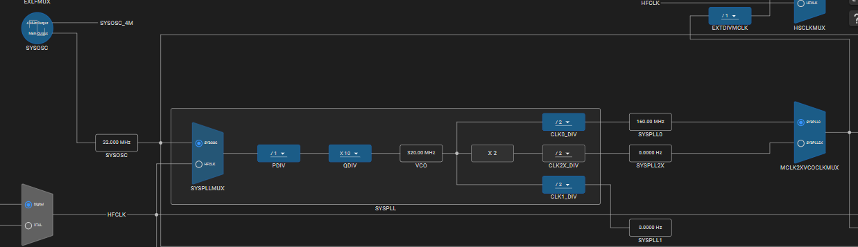

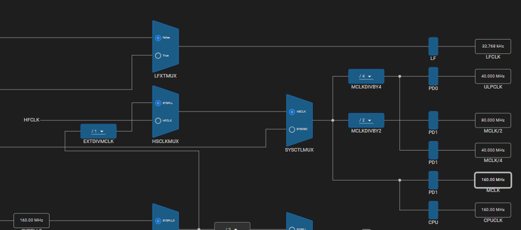

It seems like the SPI having the clock source from MCLK/2 (80MHz), which is impossible to have 25 MHz of SPI clock as the SCR =1 ( I captured this formula from the ti_msp_dl_config.c ) , is there any other ways to select the clock source from MCLK/2 (80MHz) to MCLK (160MHz) , to achieve 25 MHz.
