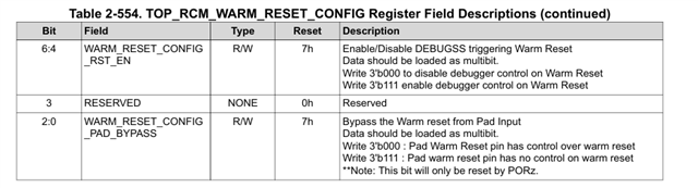

  • Hi Anand,
    As mentioned in the register descriptions, Warm reset input from PAD is disabled by default. It needs to be enabled in software, before it can be used.

    AS per API to enable the Warm reset PAD
        /* To enable ONLY PAD (disable all bypass bits including PAD) */
        SOC_configureWarmResetSource(0U);
    Even this we are not seeing any reset in the SW. Expected is to start the program the init process.
    Please provide the any sample SW for the warm reset
    This API doesn't seem to have been implemented correctly. I will raise an internal bug to get this corrected. Meanwhile, please use this updated API definition in the soc_rcm.c file and re-build the libraries before rebuilding the project, for it to take effect.

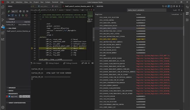

    Is the data abort seen when executing "SOC_configureWarmResetSource" or after the Warm reset input is provided on the pin? Which Instruction is causing the data abort? Can you look at the CP15_DATA_FAULT_ADDRESS under System Registers ?
    Sahana

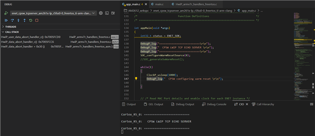

    The data abort seen while executing the SOC_configureWarmResetSource.
  • It is still trying to write into 0x00770077 which was the value of regval (previous value of ptrTOPRCMRegs->WARM_RESET_CONFIG)

    We have tested the changes, Still the issue is same as described earlier its getting into data abort
  • As a workaround, can you please try including the soc_rcm.c file with the changes inside your project directory and check if it then works fine?
  • At my end, it works fine after this change.
