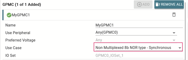

    I recommend using Sysconfig (https://dev.ti.com/sysconfig) with below setting for Use Case:

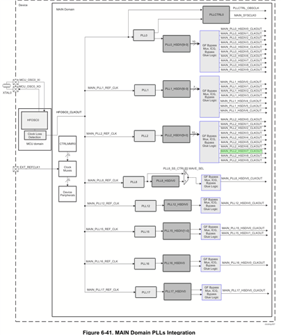

    This free-running clock is the input to GPMC selected through GPMC_CLKSEL_CLK_SEL in MAIN_CTRL_MMR_CFG0_GPMC_CLKSEL Register
    1'b0 - MAIN_PLL0_HSDIV3_CLKOUT (133/100/80 MHz)
    1'b1 - MAIN_PLL2_HSDIV7_CLKOUT (100/66 MHz)
    See https://www.ti.com/lit/pdf/SPRUIV7

    For 50MHz, you would need to...
    1) set GPMC_CLKSEL_CLK_SEL to 1'b1 - MAIN_PLL2_HSDIV7_CLKOUT
    2) and also change the change the HSDIV7 to 20. There are no other peripherals clocked by MAIN_PLL2_HSDIV7_CLKOUT so you would not affect anything except for GPMC. With the slower FCLK clock going into the GPMC logic, all GPMC timings will also be slowed down.
    MAIN_PLL2_HSDIV7_CLKOUT:
    1000/10 = (FOUTPOSTDIV/10) = 100MHz
    1000/15 = (FOUTPOSTDIV/15) = 66MHz
    1000/20 = (FOUTPOSTDIV/20) = 50MHz
    Let me ask a colleague if it is possible to make this modification or if there are forced restrictions. There is a warning in the TRM:
    WARNING: PLL register descriptions are provided for debug purposes only. These registers should not be manipulated directly from software. PLL programming and configuration should only be performed using the appropriate APIs provided by TISCI services in TI's Processor Software Development Kits (SDKs). TISCI: Power Management (PM)
    Refer to 6.4.5 PLLs in the TRM

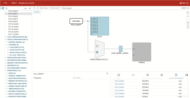

    And the SysConfig Clock Tree Tool has this selection grey and fixed to 100MHz...
    Mark
  • Actually, further down in the SysConfig Clock Tree Tool (https://dev.ti.com/sysconfig) is the GPMC0 section and it allows you to modify the HSDIV to 50MHz.
    Resulting .syscfg output is below:

    const hsdiv13 = system.clockTree["postdiv4_16ff2"];
    hsdiv13.divideValue7 = 20;
