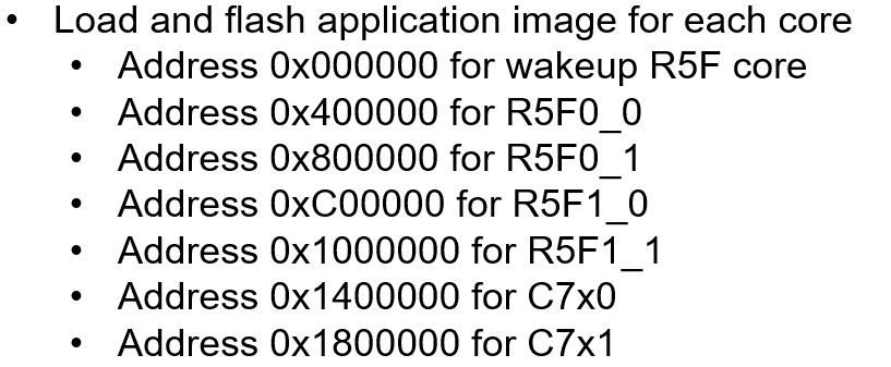

     Cusotmer has question to use UniFlash + JTAG to program multi core image in factory.
In the screen shot, you can see we only can specify one image to program. I guess the programming start address should be 0x0. However, for each core, the image start addresses is different.
 image.pngf
For example, we can see differnet images for R5F and 2 C75x DSP in demo awe_sdk_am275x_12_00_22_12/audio_app/am275.
They are not combined into one. May I know:
  1. If UniFlash support multi images programming?
  2. Or can we provide an example,use dmeo project to show customer how to combine all images belong different cores into one?

  • Hi Andre,
    The TI standard UNIFLASH: UniFlash flash programming tool does not support AM275x currently. There are two different ways to flash the application program into the flash:
    1. Using sbl_uart_uniflash, which you can program multiple images into the different locates in flash with python script. You only need to run the python script once. It is the preferred way to program application images into the flash. It only uses UART and does not use JTAG. The customer board will have UART0 wired out.
    2. Using sbl_jtag_uniflash, which you can program multiple images into the different locates in flash, but you will have to run the same program multiple times, because each run can only write to one image at one flash location by default. Of course, you can change the sbl_jtag_uniflash to fit your needs.
    To combine all the application images (for all cores involved) and form one image for sbl_jtag_uniflash is not recommended, because all the gaps between the address spaces used by various cores are huge. It will take long times to program that image into the flash.

  • Hi ,
    Due to some mistake, UART0 may not be available on customer HW. So JTAG is a workaround.
    You can upload multiple images in UniFlash. After uploading the first image, you will see an option to add additional images. Please refer to the following section in the UniFlash documentation for programming the device
    UNIFLASH_GUIDE
    Alternatively, you can use the sbl_jtag_uniflash method:
    SBL_JTAG_UNIFLASH
