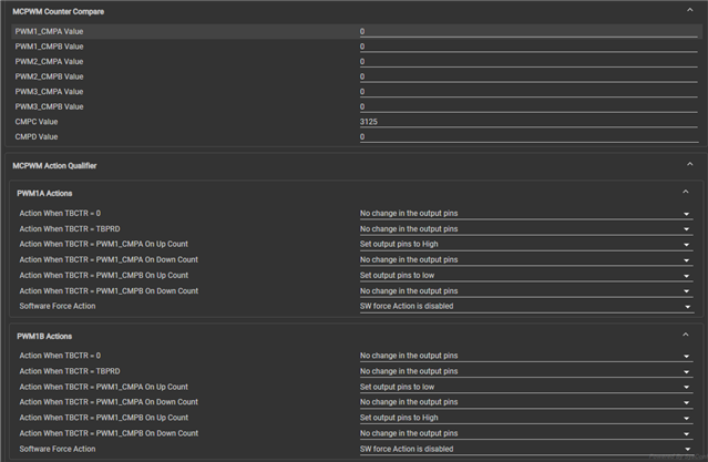

  • PWM1A is configured to:
Go high on Compare A
Go low on Compare B

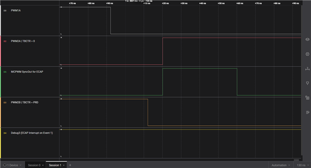

I am observing an offset in the capture counts. Please have a look at the image from the watch window
It appears that when the pulse width approaches the PWM period, the ECAP counter restarts, even though the PWM pulse width is still shorter than the configured period and Sync Out is still not generated. I have attached the Logic analyzer capture with the measurements along with Watch window when the PWM Low pulse generated is almost near to the PWM period.
Could you please help verify whether this is expected behavior or if there might be any issue in the ECAP synchronization/capture handling?

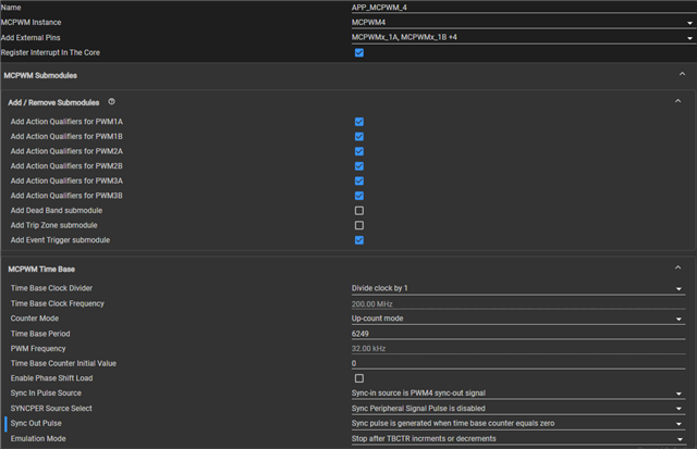

    this code is stripped down version of my application. In actual application, we need the synchronization of Counters of MCPWM and eCAP Modules.
    I am generating the SyncOut pulse when time base counter is becoming zero. I will upload the sysconfig screenshots here

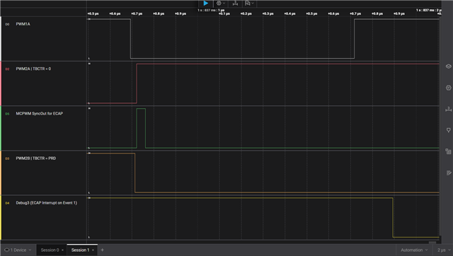

  • I am attaching the logic analyser Screenshots
    Zoomed in view
    Even More Zoomed in

    Issue 2: Boundary Overflow Near Full Period
    Your data shows Cap2 wrapping to a small value when tick_low_pulse approaches the PWM period. The following timing reconstruction explains why this occurs.
    With tick_low_pulse = 6240 and the routing delay of 12 counts:
    TBCTR = 0 : SyncOut fires, ECAP counter resets
    ECAP_CTR = 12 : PWM1A goes high, Cap1 captured (~212)
    ECAP_CTR = 212 : PWM1A goes low, Cap2 should be ~6452
    ECAP_CTR = 6237 : TBCTR reaches 6249 (PRD), rolls to 0, new SyncOut fires
    ECAP counter resets before the falling edge is captured
    Cap2 captured : 2 to 4 counts (the remaining low pulse after reset)

    Step 1: Set the ECAP Phase Register to compensate for routing delay
    This causes the ECAP counter to start at the measured offset value when the SyncIn arrives, aligning it with the actual PWM counter state and eliminating the Cap1 offset.
    DL_ECAP_setCounterPhaseValue(APP_ECAP0_INST, 12U);
