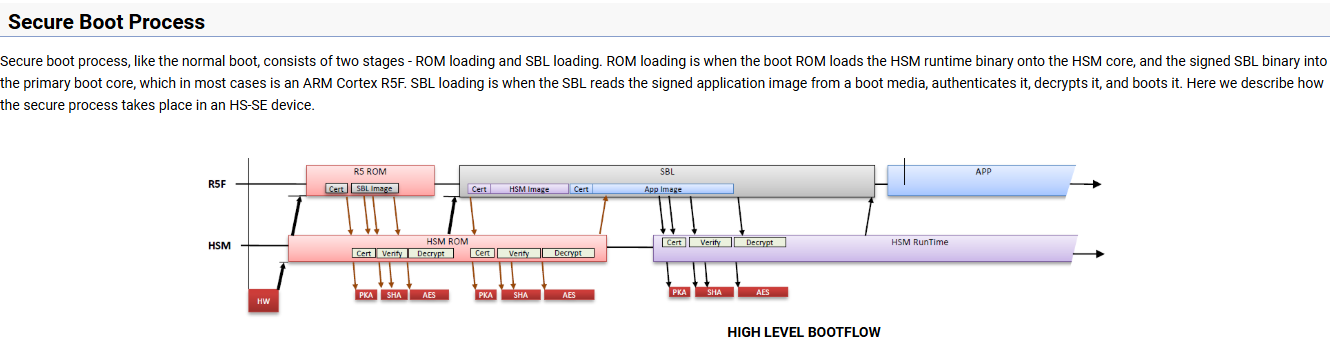

To reduce system startup time when using HSM, can we disable the HSMRT & APP image verification step in the SBL code?  22.png
    Are you using HS-FS or HS-SE device?
  • We are using HS-SE device, but we don't have secure boot requirements on project.
  • You cannot disable the HSMRT verification as this is done by ROM.
    You can either not load the HSMRT if you are not using the M4 core.
    You can disable the verification of App image. If you are using Bootloader_parseAndLoadMultiCoreELF to load the image then you would have to modify the below struct member .isAppimageSigned to False to not authenticate the image.

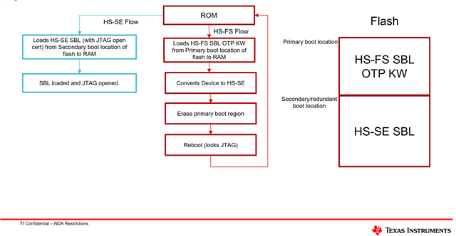

  • Hi Chun,
    Yes, in this case, one option would be to place the HS-SE SBL into the redundant boot location (which has debug enable). Flash SBL OTP KW to primary location and HS-SE SBL into the redundant boot location together, so that when the device is HS-FS, the SBL OTP KW is executed and when it coverts to HS-SE, the secondary location HS-SE SBL is executed as the primary location has HS-FS firmware.
    Thanks and Regards,
    Nikhil Dasan
  • Hi Nikhil,
    Thank you.
    Could you please share detailed steps or links regarding this process?
    I believe the process of transitioning from 'HS-FS → boot SBL OTP KW → HS-SE → boot HS-SE SBL' is handled automatically by the BOOTROM, is that correct?
  • I believe the process of transitioning from 'HS-FS → boot SBL OTP KW → HS-SE → boot HS-SE SBL' is handled automatically by the BOOTROM, is that correct?
    That is correct. All you have to do is to place the binaries in the respective locations.
    I've created a flow diagram for your reference.
    For more on redundant boot, please refer to 5.5 Redundant boot support chapter in TRM

    I believe the "Erase primary boot region" step is performed within the OTP Keywriter SBL, correct?
    We are currently using otp_keywriter_am263x_SR_11_10_01_00_00, and it appears that this version does not include the primary boot region erasure function.
    Could you help give more details how to add "Erase primary boot region" feature?
  • Yes, it does not include the erase part. This can integrated at your end or you can later use uniflash to flash your updated HS-SE binary later, as you already have JTAG unlock HS-SE binary in the redundant location. So even after conversion, upon every reboot, the JTAG will be unlocked because of this.

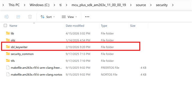

    Did you copy the OTP KW package into the latest MCU_PLUS_SDK folder?
    i.e. please copy the sbl_keywriter as shown below.
    If you have already done this, then please modify the example.syscfg file (--product) by referring to the "hello world" example of the sdk you are using.

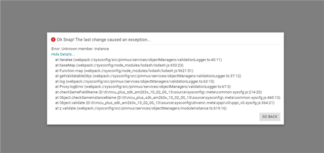

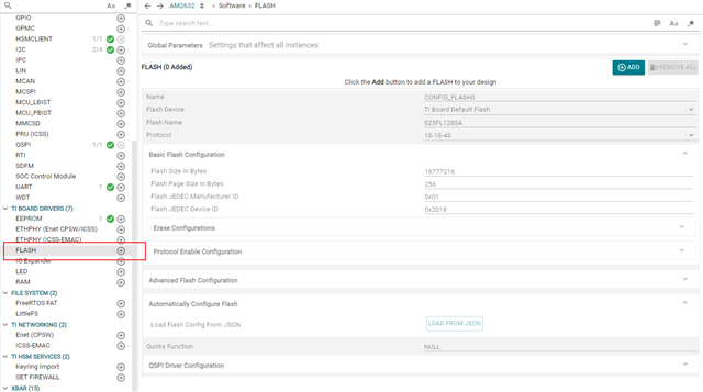

  • Hi Nikhil,
    We have been able to import the sbl_keywriter project into SysConfig. However, there was an issue when editing the FLASH module. Is there any way to solve this?
    Hello Nikhil,
    Could you help reply this issue?
    CC
    I'm able to configure flash in SDK 10.1 and OTP KW 10.1 environment. May I know when you are seeing the issue and what is the environment that you are using?
