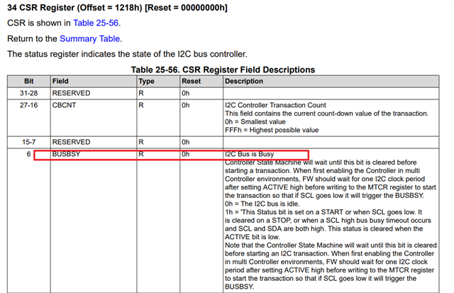

I am asking this for our customers.
In the I2C modules for MSPM0G3507 and G3519,
Would you please confirm these bus busy bits set/clear condisitons?
CSR Register[6] BUSBSY
CSR Register[0] BUSBSY
TSR Register[6] BUSBSY

    The CSR BUSBSY/BUSY bits are described in TRM (SLAU846D) Sec 25.2.3.2 and Tables 25-12 and 25-56. There's also Erratum I2C_ERR_13 [Ref Errata (SLAZ758D) p. 12].
    In my experiments (last year) I was unable to reliably use them based on their observed behavior, so I don't. Rather I use the TXDONE/RXDONE events along with the ERR bit, and (only) after that a check for IDLE.
    The TSR BUSBSY is described in TRM Table 25-69, which is rather sparse. That said, I haven't thought of a way to use it (since the Target side has no influence), rather relying on the START and FIFO events.

    Controller Mode:

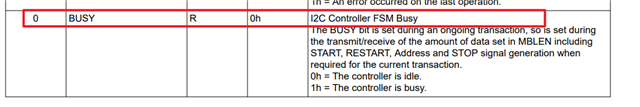

    There will have two flag bits: CSR.BUSBSY(I2C Bus is Busy) and CSR.BUSY(I2C Controller FSM Busy)
    • CSR.BUSBSY: This used to detect if I2C bus finish transfer, so the clear even will be Stop signal or timeout signal, set event will be Start signal.
    • CSR.BUSY: This is Controller FSM busy bit, if Controller need have some action to I2C bus, this bit will be set within 3 functional clock. Then cleared after addressing this action. Check Errata -> ADC_ERR_13. If user want polling this bit to see if finish I2C data transmission, need add some delay before checking.
    Target Mode:
    TSR.BUSBSY keep same logical with CSR.BUSBSY. TSR no other FSM busy bit.
