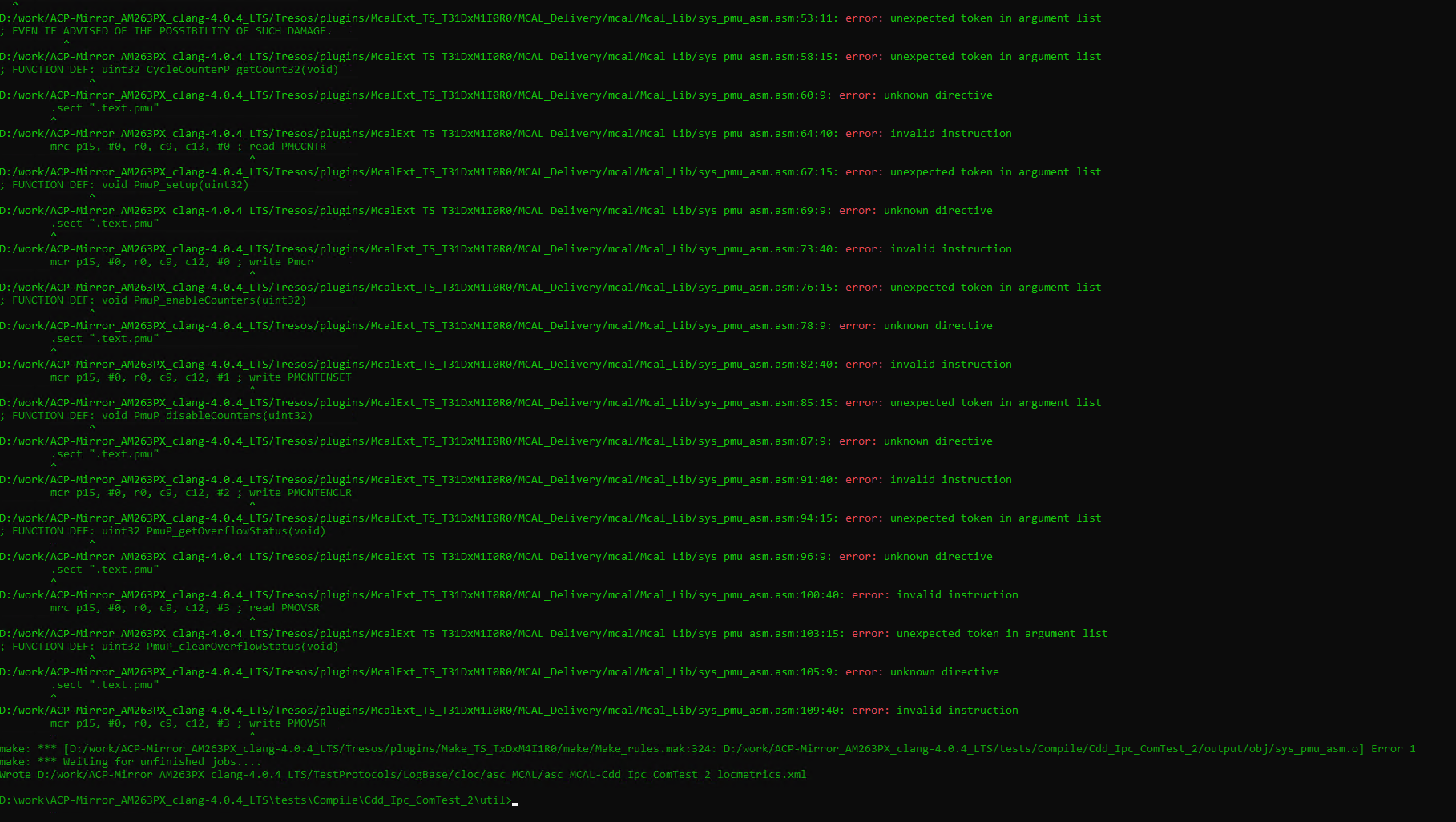

Below is the error message reported while integrating Cdd_Ipc driver from above mentioned MCAL Package:

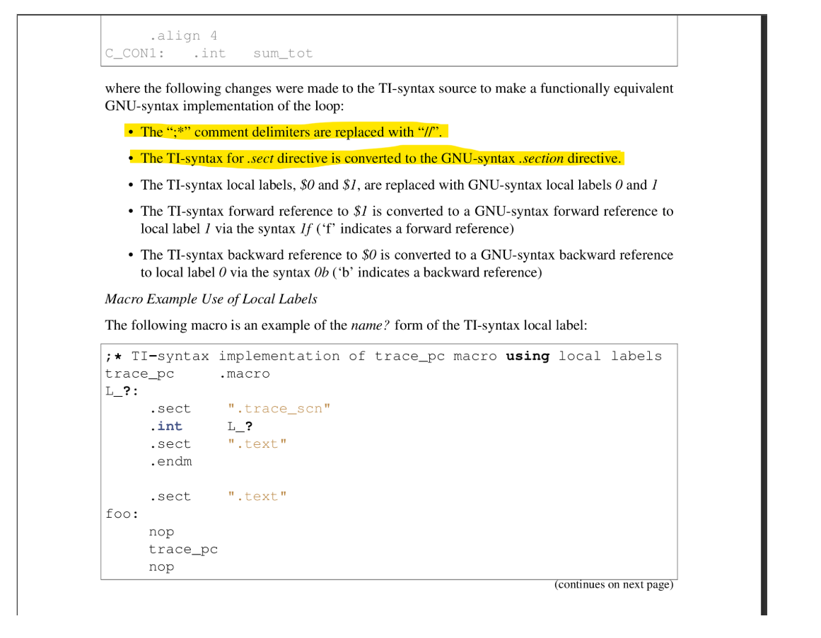

We are using compiler ti-cgt-armllvm_4.0.4.LTS, assembler doesn't recognize or support ";" for comments and assembler directive .sect ".text.pmu" for code section.

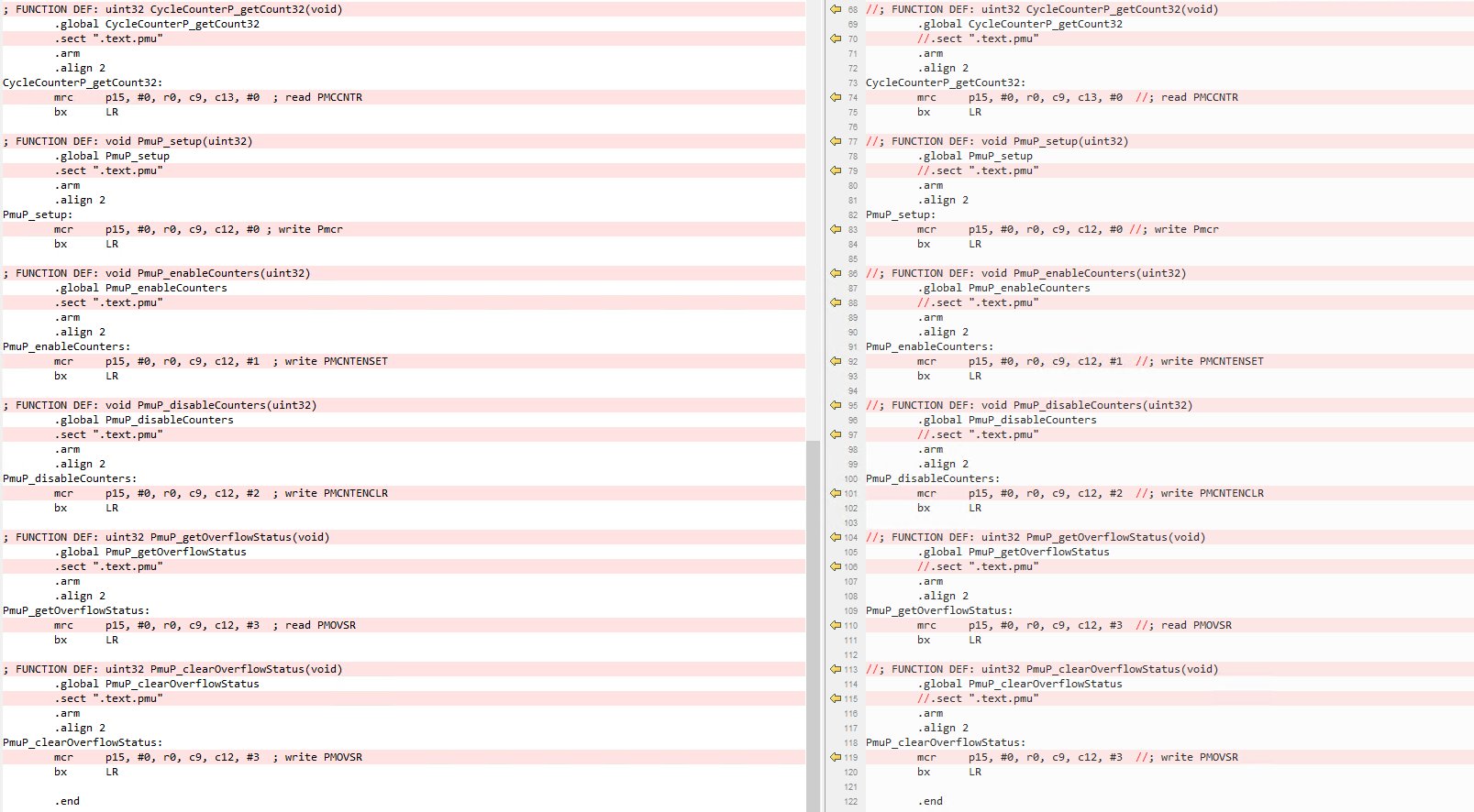

After updating "sys_pmu_asm.asm" as per TI_Arm_Clang_Compiler_Tools_User_Guide, we are able to fix the issue.
After updating the comment from ";" to "//" it is compiling
Can you please check and provide me your feedback

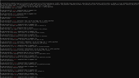

  • Hello Nikhil,
    We have tried to use the flag -x ti-asm. but we are not able to build the file, and it is showing error as below:
    We have used these options to build the sys_pmu_asm.asm file:
    tiarmclang.exe -D_EMPTY -DOSB_TOOL=OSB_clang -mcpu=cortex-r5 -mfpu=vfpv3-d16 -mfloat-abi=hard -mlittle-endian -g -mthumb -x ti-asm -DATOMICS_USER_MULTICORE_CASE=0 -DTS_ARCH_FAMILY=TS_ARM -DTS_ARCH_DERIVATE=TS_AM263PX -DOSB_TOOL=OSB_clang -DAM263PX_SIP_PACKAGE=0 -DSOC_AM263PX=0 -DAM263PX_PLATFORM=0 -DIP_VERSION_LBIST_V0=0 -DIP_VERSION_ESM_V2_0=0 -DDebugP_ASSERT_ENABLED=0 -DMCALEXT_IRQ_USE_OS=1 -DATOMICS_USE_GENERIC_IMPL=1 -c -x assembler-with-cpp sys_pmu_asm.asm -o sys_pmu_asm.o
    Can you please confirm which executables were used by TI to build this file?
    can you please check and provide your feedback
    Mohasin

  • Hello Nikhil,
    On our test environment, flag -x assembler-with-cpp is enabled by default to interpret subsequent files as GNU-syntax Arm assembly source files that will be preprocessed by the compiler.
    After discussing internally, it is recommended to continue with replacing comment style ";" with "/" for GNU-syntax as an integration step. No modification is needed from TI side.
    Mohasin
  • Hi Mohasin,
    Wanted to do a quick check at your end before confirmation. The issue here is that if you pass -x multiple times, only the last one will take effect. So in this case the file is compiled with -x assembler-with-cpp because it was passed after -x ti-asm.
    The issue would resolve for this file if you pass -x ti-asm at the end (i.e. after -x assembler-with-cpp)
