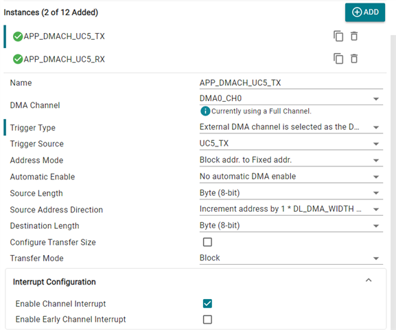

    In the DMA configuration in Sysconfig, I'm unsure what to configure in the "Address Mode" and "Transfer Mode" fields.
    In the UART configuration in Sysconfig, what should be entered in the "Configure DMA TX Trigger" field?

    The "Configure DMA TX Trigger" and "Configure DMA RX Trigger" inputs are configuring the signal from the UART perspective. Some DMA trigger paths have more than one condition option (for example UART RX has RX FIFO level trigger OR receive timeout trigger option.) For this you can just select one and keep the enable box checked.
    Inside the DMA module in Sysconfig, you need to determine the transfer and addressing mode you want to use based on the nature of your data. For the TX side, is all the data you want to transmit laid out in a memory buffer? Or will software update a single memory location? What about on the RX side - how does received data need to be placed in memory?

  • Ok, My actual application is pretty complicated as I need to implement a custom protocol based on UART. It involves upto 6-7 DMAs and Timers chained together for my requirement. I am facing some basic issues. I have created stripped down version of my application as specified below.
    Goal
    Transmit the data from txbuffer using DMA and Receive the data using DMA into the rxbuffer. I am not using the Tx and Rx FIFO thresholds.
    Configurations for UART5 (specifying important and nondefault values)
    • Baud Rate : 5M
    • RX Timeout Interrupt Counts : 15
    • DMA RX Trigger : UART RX Interrupt
    • DMA TX Trigger : UART TX Interrupt
    • Tx Pin : A22 | Rx Pin : A10 | UC5
    TX DMA : APP_DMACH_UC5_TX
    RX DMA : APP_DMACH_UC5_RX

        /* TX DMA Configuration */
        DL_DMA_setSrcAddr(APP_DMACH_UC5_TX_DMA_INST, APP_DMACH_UC5_TX_CHANNEL_ID, (uint32_t)txbuffer);
        DL_DMA_setDestAddr(APP_DMACH_UC5_TX_DMA_INST, APP_DMACH_UC5_TX_CHANNEL_ID, (uint32_t)&UC5_UART->TXDATA);
        DL_DMA_setTransferSize(APP_DMACH_UC5_TX_DMA_INST, APP_DMACH_UC5_TX_CHANNEL_ID, MML_TX_BUFFER_SIZE);
        DL_DMA_enableChannel(APP_DMACH_UC5_TX_DMA_INST, APP_DMACH_UC5_TX_CHANNEL_ID);
        /* RX DMA Configuration */
        DL_DMA_setSrcAddr(APP_DMACH_UC5_RX_DMA_INST, APP_DMACH_UC5_RX_CHANNEL_ID, (uint32_t)&UC5_UART->RXDATA);
        DL_DMA_setDestAddr(APP_DMACH_UC5_RX_DMA_INST, APP_DMACH_UC5_RX_CHANNEL_ID, (uint32_t)rxbuffer);
        DL_DMA_setTransferSize(APP_DMACH_UC5_RX_DMA_INST, APP_DMACH_UC5_RX_CHANNEL_ID, MML_RX_BUFFER_SIZE);
        DL_DMA_enableChannel(APP_DMACH_UC5_RX_DMA_INST, APP_DMACH_UC5_RX_CHANNEL_ID);

    I am triggering the UART DMA by calling this function in one second loop
    DL_UART_transmitData(APP_UART_0_INST, txbuffer[0]);
    I am first testing with UART Tx DMA and I observe following issues
    • The DMA start sending the data as soon as I enable the DMA  during initialisation process. It should have waiting untill I manually send one byte to start triggering for further buffer transmission. I checked the Interrupt flag and TXIFG flag is set when checking the debug mode before the enable channel was done.
