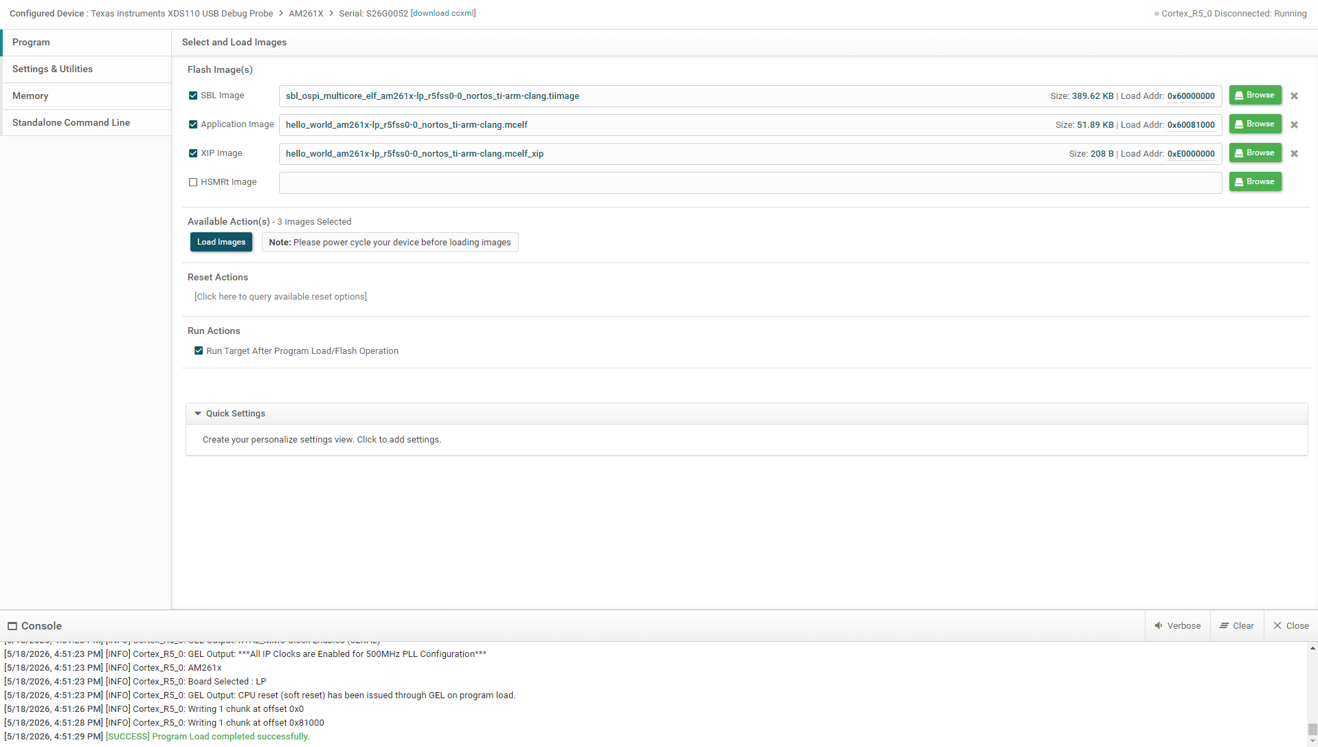

To isolate the issue, I tested first on the AM261x-LP LaunchPad. I built the unmodified example (also tested in Debug). It generates:
sbl_ospi_multicore_elf_am261x-lp_r5fss0-0_nortos_ti-arm-clang.tiimage
Using TI UniFlash, I flashed the generated sbl_ospi_*.tiimage and the hello_world_*.mcelf while the board was in DEVBOOT pin configuration (screenshot attached). After switching the boot pins to OSPIBOOT, I no longer see any output on the serial console.
Note: If I flash the prebuiltsbl_ospi_*.tiimage from TI, OSPI boot works correctly. Only the SBL image I build from the SDK example fails.
Could you please advise what could be missing/misconfigured (boot mode, OSPI settings, image format/alignment, UniFlash steps, etc.) and why the TI example build might not boot on AM261x-LP?
