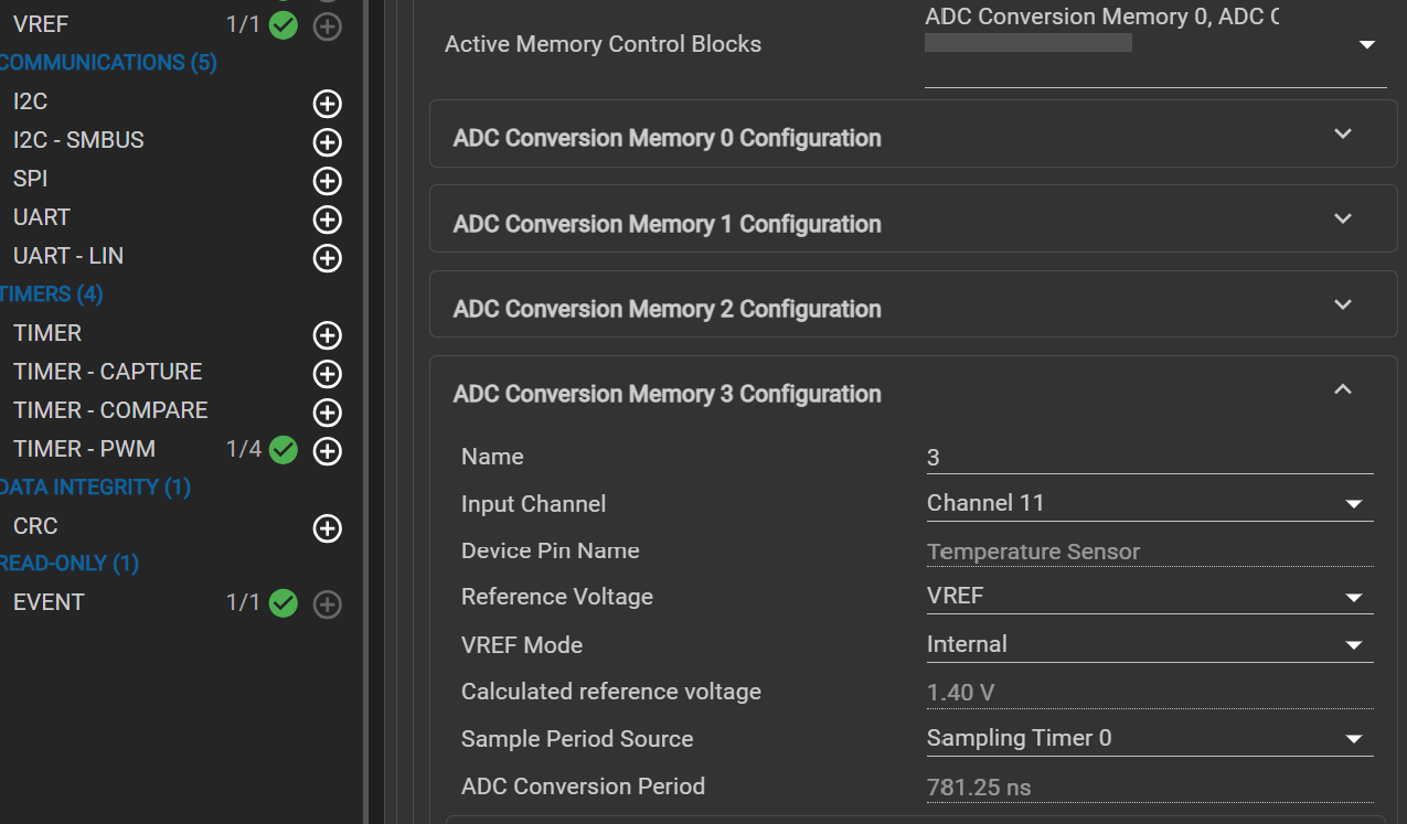

  • Thanks Sal!
    1- Right now, Sample Clock Divider is Divide by 1 and Calculated Sample Clock Frequency is 32MHz and ADC Conversion Period is 781ns, if I increase Sample Clock Divider is Divide by 16 and Calculated Sample Clock Frequency is 2MHz and ADC Conversion Period is 9us. Do you mean this change?
    2- I need to use ADC12's Conversion Mode as sequence, to sample 3 voltages and one temperature sensor. Is it possible to have slow conversion time for temp sensor, and faster for these 3 voltages in Sequence Conversion Mode?

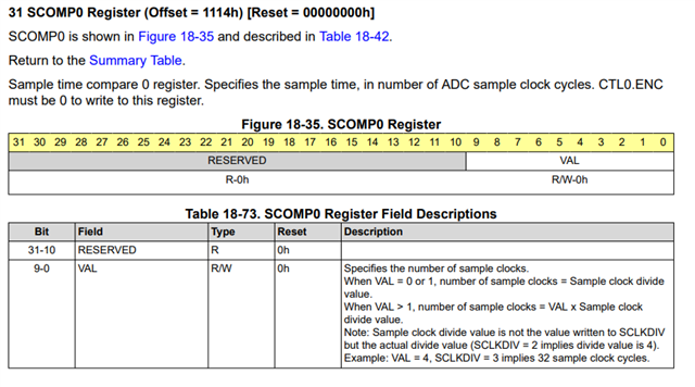

    The sample time only take care of the below settings:
    It is 10-bit register:
    Make sure your VAL is not overflow with larger sample time setting.
    10us = 320 * 1/32MHz <1024. There is no need to further divide SAMPCLK.

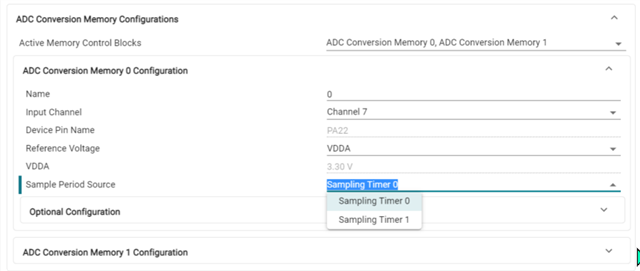

    Yes, we have two sample window for user's selection. You can set different value, and pick the larger one for internal temperature sensor only.
