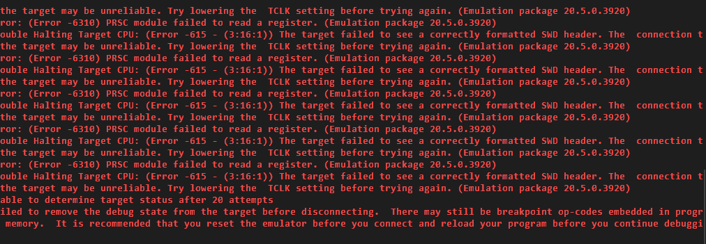

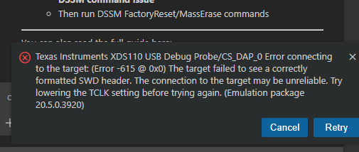

When trying to connect am13x launchpad we get the following errors;
CS_DAP_0: Error connecting to the target: (Error -615 @ 0x0)
The target failed to see a correctly formatted SWD header.
The connection to the target may be unreliable.
Try lowering the TCLK setting before trying again.
  • This might happen when you might have configured PA14(SWCLK)  or PA15(JTAG/TDI)  pins .

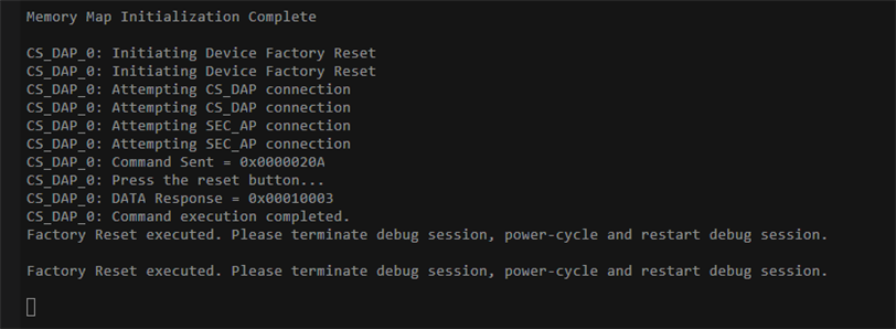

    To solve this :
    • connect jumper to j11 (Located beside the bsl inv button)
    • hold the bsl inv button on launchpad and connect the board
    • issue dssm factory reset command (located under Scripts Menu in  CCS , )
    • release the bsl inv button , press reset button when msg is displayed for it in gel output , reconnect the board.
    Reference : {am13x sdk}/docs/am13e230x/user_guide/chapters/getting_started/ccs_debug_tips.html
