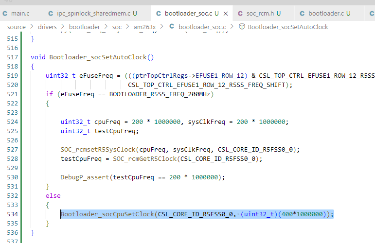

1 Can we modify CPU clock frequency to 380M or 390M Hz in bootloader.
2 There is only one line code to set R5-0 core in bootloader code. You can see below picture at line 534. But our project used two cores. So I want to know where  is the clock setting of R5-1 .image.png

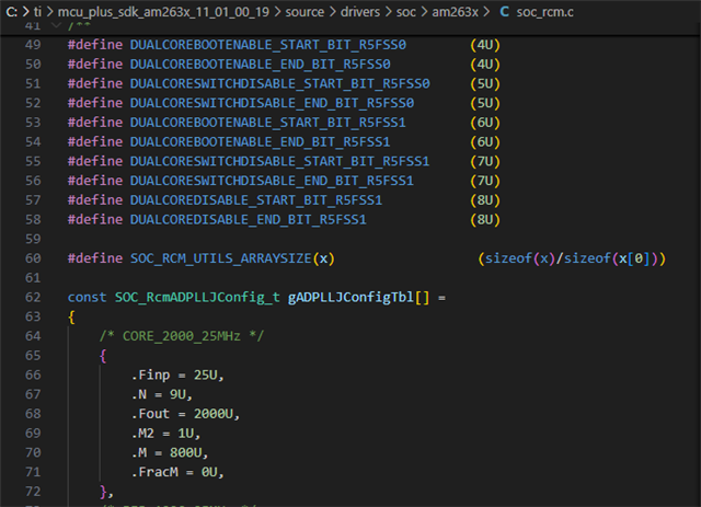

    This would need modifications in the PLL settings, including the PLL lock frequency and is not very straight forward. By default, the PLL is locked at 2000MHz, and divided by 5 to obtain 400MHz. The following values need to be calculated and changed
    as per this formula:
    These settings are also explained in the section "Sequence to Configure the CORE PLL" in the Device TRM (AM263x SitaraTm Microcontroller Technical Reference Manual (Rev. I))
    This is part of "Bootloader_loadCpu(bootHandle, &bootImageInfo.cpuInfo[CSL_CORE_ID_R5FSS0_1]);"

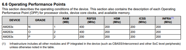

    3 Another question is that our CPU are run at 200MHz frequency actually if our board is HS-SE device?
        Because if (eFuseFreq == BOOTLOADER_R5SS_FREQ_200MHz) returns true.
    This would be for devices with part number "AM263xxPxx..." devices. for example, "AM2632CPDFHMZCZRQ1" as in the datasheet:
