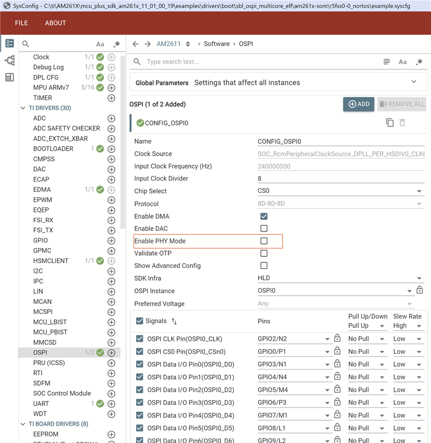

  • Hi Robert,
    Please try this configuration.
    PLL configs are done from SBL. So in your SBL, here I have taken this project as sbl: examples\drivers\boot\sbl_ospi_multicore_elf\am261x-som
    1. Configuration in Clock tree tool
    2. Configuration in OSPI Section. Turn OFF PHY
    Do the same process in application as well. Both the clock tree and OSPI PHY configuration
    In application, the PLL configuration is necessary because based on its inputs, the application also verifies if the PLL configuration made in SBL matches with what that is configured.
    I am attaching my sysconfigs

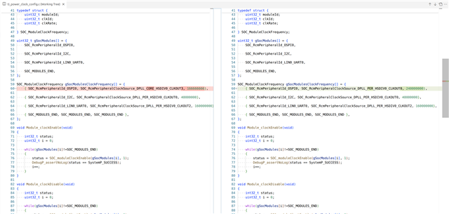

  • Hi Aswin,
    I used sbl_ospi_multicore_elf_am261x-lp_r5fss0-0_nortos_ti-arm-clang project as my custom board project and made some changes as your mention as below git snapshot (before versus after). The boot media clock changed to 30MHz as yours but the waveform measured at opsi clock pin still keeps about 7.5MHz square waveform. Could you please kindly help check any possibilities? Thanks.

    [OSPI0 Clock Register Dump] Robert Huang 20260603
    1. TOP_RCM_PLL_CORE_M2NDIV [0x53200410] = 0x00010009
    M2[23:16] = 1, N[7:0] = 9
    2. TOP_RCM_PLL_CORE_MN2DIV [0x53200414] = 0x000000C8
    M[11:0] = 200, N2[19:16] = 0
    3. TOP_RCM_PLL_CORE_FRACDIV [0x53200418] = 0x02000000
    FRACTIONALM[17:0] = 0, REGSD[31:24] = 2
    4. TOP_RCM_PLL_CORE_HSDIVIDER_CLKOUT0 [0x5320042C] = 0x00000320
    DIV[4:0] = 0, GATE_CTRL[8] = 1, PWDN[12] = 0, STATUS[9] = 1
    5. MSS_RCM_OSPI0_CLK_SRC_SEL [0x532081F0] = 0x00000333
    CLKSRCSEL[11:0] = 819
    6. MSS_RCM_OSPI0_CLK_DIV_VAL [0x532083F0] = 0x00000000
    CLKDIVR[11:0] = 0
    BR, Robert Huang
