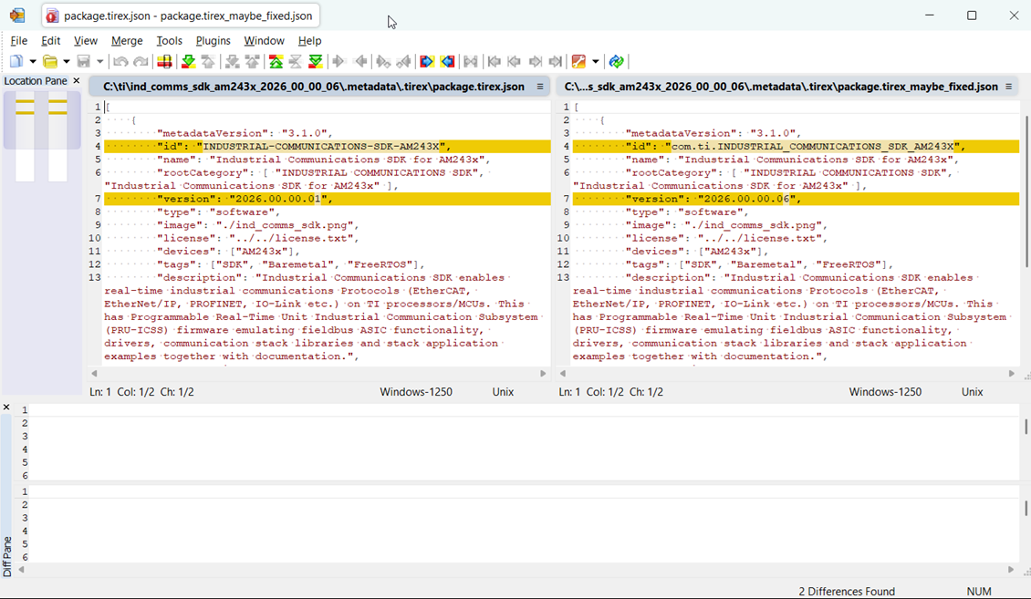

I have received early not-yet-published release of "Industrial Communications SDK" v2026.00.00.06.
I noticed that the "Industrial Communications SDK" (IndCommsSDK) identifier differs from those used in all previous Industrial Communications SDK versions.
Could you please clarify the reason for this change? Allowing multiple IndCommsSDK versions to be applied in parallel (due to different identifiers) is not appropriate.
I would kindly ask you to check and fix this issue, ideally before the public release of Industrial Communicatins SDK v2026.
Please see screenshots below for more details, including a suggested fix in the latest file.
Thank you in advance.
Vit Triska

    Do you plan to rename the ID format and change the meaning of version tag for all future SDK products/releases (<product>\.metadata\.tirex\package.tirex.json)?
    Otherwise, I do not understand why this change is being to be introduced so unexpectedly...

    IndCommsSDK | ID | version
    ind_comms_sdk_am243x_09_02_00_15: "id": "com.ti.INDUSTRIAL_COMMUNICATIONS_SDK_AM243X", "version": "09.02.00.15",
    ind_comms_sdk_am243x_09_02_00_24: "id": "com.ti.INDUSTRIAL_COMMUNICATIONS_SDK_AM243X", "version": "09.02.00.24",
    ind_comms_sdk_am243x_11_00_00_08: "id": "com.ti.INDUSTRIAL_COMMUNICATIONS_SDK_AM243X", "version": "11.00.00.08",
    ind_comms_sdk_am243x_11_00_00_13: "id": "com.ti.INDUSTRIAL_COMMUNICATIONS_SDK_AM243X", "version": "11.00.00.13",
    ind_comms_sdk_am243x_2025_00_00_08: "id": "com.ti.INDUSTRIAL_COMMUNICATIONS_SDK_AM243X", "version": "2025.00.00.08",
    ind_comms_sdk_am243x_2026_00_00_06: "id": "INDUSTRIAL-COMMUNICATIONS-SDK-AM243X", "version": "2026.00.00.01",
    What is the rationale behind this change?
    From my perspective, it appears inconsistent and potentially problematic.
    Regards, Vit

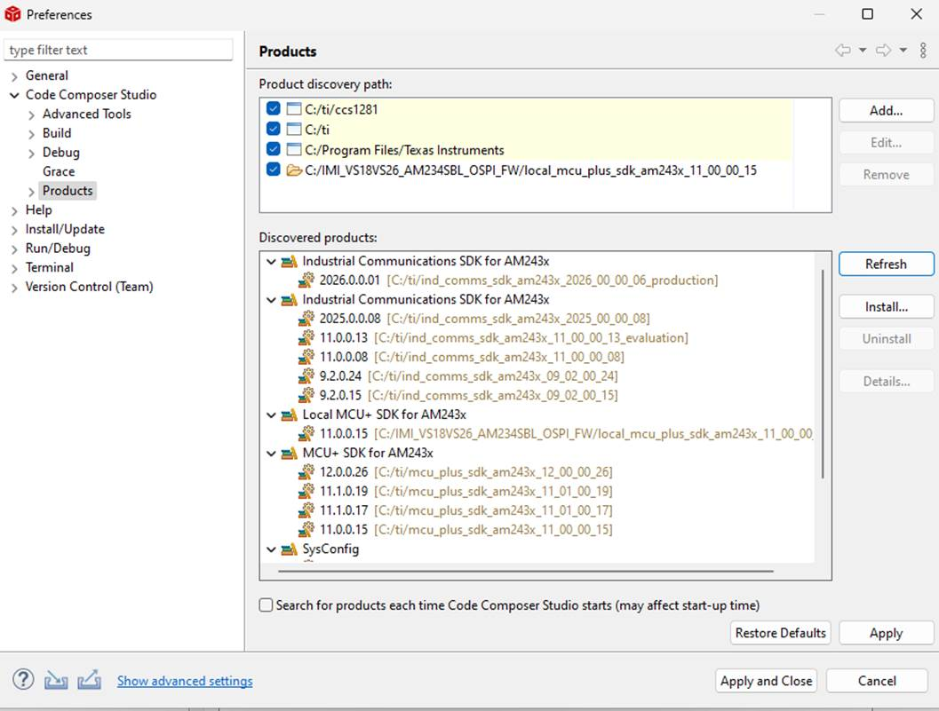

    I noticed a couple of inconsistencies and I would appreciate your clarification:
    1) Why are there two product categories with the same name?
    Allowing e.g. both v2025.00.00.08 and v2026.00.00.06 to be added to a single project (at the same time) is not wanted.
    2) Why does the versioning appear incorrect?
    Is it v2026.00.00.01 or v2026.00.00.06?
    I assume these 2 issues are unintentional. Could you please clarify or forward these findings to the appropriate team for correction?
    Thank you for your assistance.
    Regards, Vit
    we are checking that internally and let you know.
    The v2026.00.00.01 is for sure a mistake.
    Christof
