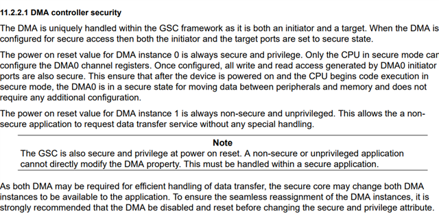

  • Hi James,
    I believe that you may be hitting one of the security related configurations for this device. Do you go to the default handler when using DMA1?
    See this section of the GSC chapter in the TRM:
    If you're hitting the default handler you can just change the DMA settings to set it as secure and priviledged.
  • I had already tried that as one of the examples (dma1_block_transfer) was doing that for memory to memory DMA transfer.
    The solutions seems to be as I described above, the DMA triggers from the UART apparently need to be routed to the other DMA controller using.
    DL_GSC_setRegularTriggerDMAInstance
    There's minimal documentation for that, although the tech reference manual does mention it.
