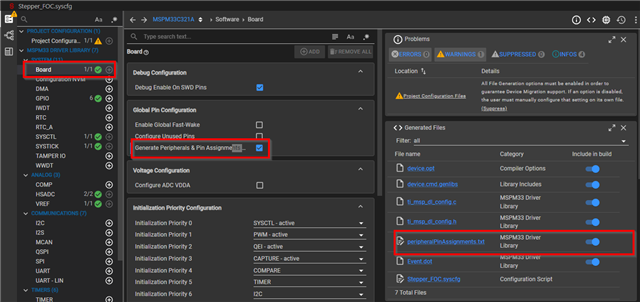

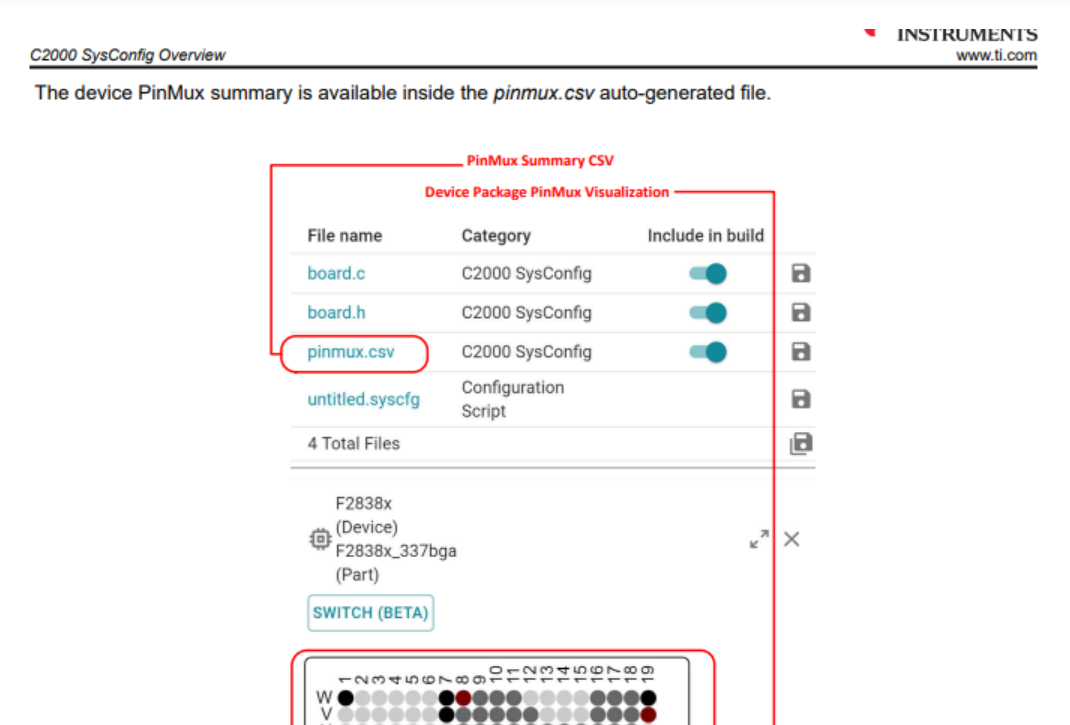

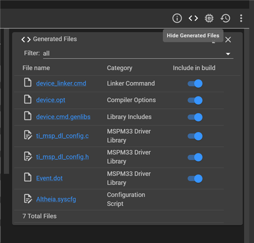

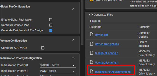

I would like to ask whether the current SDK for MSPM33 have the support to export the PinMux just like the C2000 as below. As I can't find it in the CCS syscfg for MSPM33. image.png
