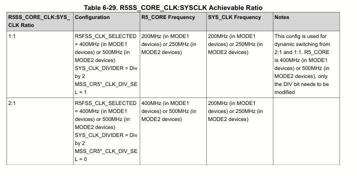

  • AM261 SoC can be run at 200 MHz CPU Clock frequency. This can be achieved by modifying the PLL configurations to adjust the CPU clock and SYS Clock.
    When running at 200MHz, there is a required frequency ratio mentioned in the AM261 TRM. This needs to be followed. This ratio of clock frequency between CPU and Sysclock needs to be followed

    • Added a new 200MHz mode in addition to existing 400MHz and 500MHz mode.
    • HSDIV0 PLL is used as source to CPU Clock.
    • Bootloader_socSetAutoClock() modified to set CPU and SysClock to 200MHz
    • HSDIVOU0 CORE PLL is now used as source to CPU Clock

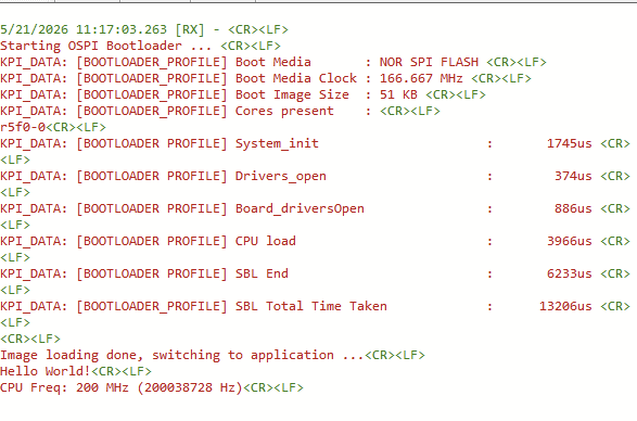

    4. Build the hello world example. To measure CPU speed, the below code snippet can be called from hello world example
    void measureCpuSpeed(void)
        uint32_t startCounter = CycleCounterP_getCount32();
        uint32_t startTime = ClockP_getTimeUsec();
        ClockP_usleep(1000);
        uint32_t endCounter = CycleCounterP_getCount32();
        uint32_t endTime = ClockP_getTimeUsec();
        uint32_t elapsedCycles = endCounter - startCounter;
        uint32_t elapsedUsec = endTime - startTime;
        if (elapsedUsec > 0)
            uint32_t cpuClockMHz = elapsedCycles / elapsedUsec;
            uint32_t cpuClockHz = (uint32_t)(((uint64_t)elapsedCycles * 1000000) / elapsedUsec);
            DebugP_log("CPU Freq: %u MHz (%u Hz)\r\n", cpuClockMHz, cpuClockHz);
    Flash the images and observe the output
