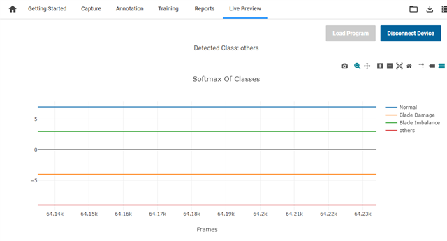

Hi experts,
We are evaluating the system under the following environment; however, the results displayed on the Live Preview screen are not as expected.
Even though no modifications have been made to the motor, the classification result is shown as “Other” instead of “Normal.”
Could you please point out if there are any mistakes in our procedure?

■ Observation
The result does not change regardless of which of the following methods is used:
Pattern 1:
Build motor_fault_live_preview_LP_MSPM0G5187_nortos_ticlang in CCS and flash the generated .out file
Pattern 2:
Train the model based on Fan Imbalance Classification with default settings, and then program the device using “Load Program”

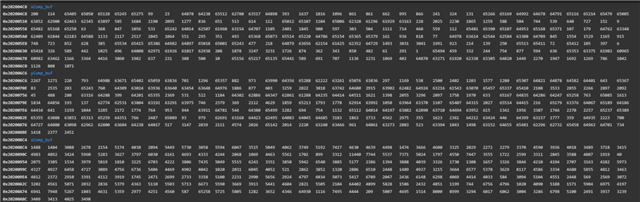

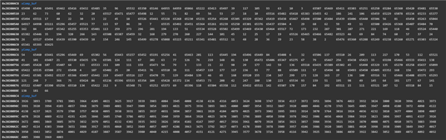

  • Hi Sal,
    First, I apologize that the measurement results are difficult to read.
    I added buffers to “motor_fault_data_capture_LP_MSPM0G5187_nortos_ticlang” and visualized the measured values for the X, Y, and Z axes.
    The sensor was mounted on top of the fan, and measurements were taken under the following three patterns.
    As a result, the sensor itself appears to be operating, but I cannot determine whether the measured values are valid or reasonable. When the sensor is not mounted on the fan, each axis shows changes in the expected direction according to the direction in which the sensor is tilted.
    Pattern 1: Normal condition. The values are stable on all axes.
    Pattern 2: Touching the blade with a finger. The values fluctuate significantly on all axes.
    Pattern 3: Attaching tape to the blade. The values fluctuate on all axes, but not as much as in Pattern 2.

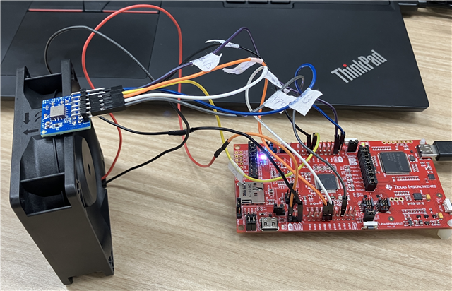

  • Hi Sal,
    Thank you for your reply. Sorry for the insufficient explanation.
    In our setup, the sensor is mounted on top of the BLDC motor and not on the blade for all 4 classes. This is different from what you are doing.
    The setup is as shown in the photo. The sensor is mounted above the BLDC.
    Additionally, when you test the normal case, does the motor is spinning or keep static?
    The BLDC used is “SUNON EF80251S1-1000U-A99,” and it is always spinning.
    Since we only have one “SUNON EF80251S1-1000U-A99,” we have not damaged any of its blades. For another type of BLDC, we prepared both a normal unit and a unit with a damaged blade, and we have already tried the full process from custom data capture to re-train and compilation using “motor_fault_data_capture_LP_MSPM0G5187_nortos_ticlang.”

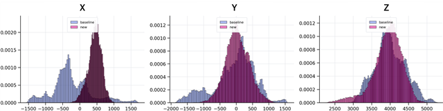

  • Hi Sal,
    I've attached a project using the sample project as the default, and then another project based on that default using data I captured myself as the custom.
    The following graph summarizes the differences between the default and custom .csv files.
    O.H

  • Hi Sal,
    I managed to resolve the issue, albeit through a workaround. There was a discrepancy between the logic displayed in the GUI and the logic implemented in the source code. I modified the source code to align the UART output sent to the GUI with the LED display.
