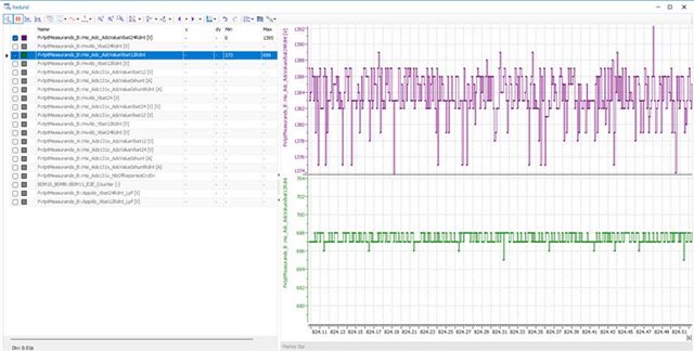

when h/w averaging is enabled on both ADCs concurrently, the output seems having averaging only on ADC0 but not on ADC1, if the only difference in the code that ADC0's h/w averaging is off - but setup for ADC1 is preserved - h/w averaging on ADC1 seems to be appearing. Unable to locate any info on such an issue. please advise.
  • this pic shows both ADCs with h/w averaging enabled
    this one shows purple channel having h/w averaging disabled while the green one has ZERO alterations :

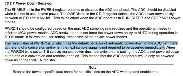

  • Hello Sal, thanks for the input. it turns out the culprit is     DL_ADC12_setPowerDownMode(ADC12_0_INST,DL_ADC12_POWER_DOWN_MODE_MANUAL);
    if it is set - always on - ADC produces pretty consistent returns, but in default powerdown-when-not-converting - the results on the same stable input are dispersed more widely. does it a known feature?
  • Hi Mykhaylo,
    Yes, this is mentioned in TRM ADC chapter:
    We recommend using manual power down mode if there has no extreme power consumption requirement.
    Otherwise, we need set larger sample time to cover the ADC wake up and enable time.
    B.R.
    Sal
  • Thank you Sal for helping me. What I was trying to get is the conversion results stability difference between always-on mode and default automatic powerdown. imagine the analog input of very stable 1V transits into digital 100 output of the ADC. if it is always-on - the readings are 99, 100 and 101, nothing more. but if automatic powerdown is in play - the readings start jump to 97,98, 102 and 103 at least with rare jumps to 96 or 104. could you see such effects on your side? does it documented anywhere? or maybe it is some issues with my board's layout and this is attributes of increased current drive where supply voltage dips and produces such readings? please advise
  • Hi Mykhaylo,
    As I mentioned, this is due to ADC is not stable to start ADC conversion when working in AUTO mode. We have no analysis on the relationship of its impact.
    While I believe if you set larger sample time (cover the ADC wakeup, enable, and original ADC channel sample time), then you can get the same stable ADC conversion result.
    The wake up time takes 5us max:
    The enable time normally takes several ULPCLK cycles:
    For example, if you set the original sample time as 1us, then you should set it to 1+5+0.1=6.1us to cover the required timing.
    This is insufficient way when work in hardware average mode, as only the first conversion requires the larger sample time to wait ADC wakeup, and the following repeat conversions (for hardware average) only seek for small sample time.
    B.R.
