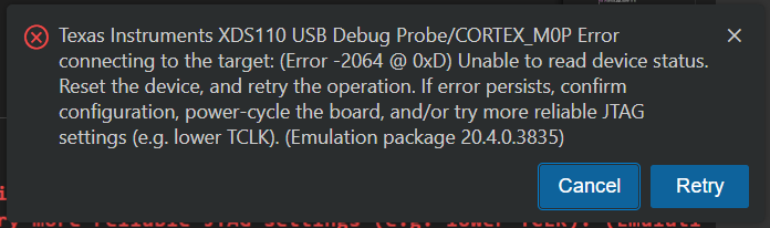

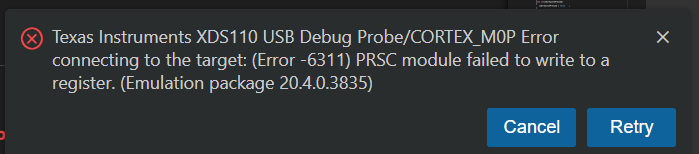

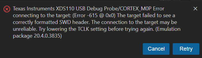

image.png I am facing regular issue with connection lost, programming failure etc. Sometimes work fine.

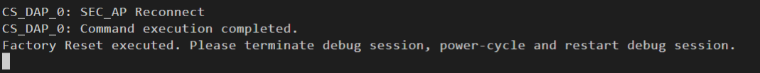

Factory reset working fine but flash programing and debugging have problem
Just after factory reset but programming fail
Is the connection correct for debugging and flash programming? relating documents or manual will help me lot.

    Board is powered from 12V battery -> 5V regulator -> 3.3V regulator. final VDD = 3.319V
    I found capacitor on NRST 0.01uF/50V value changed. Now I replaced the capacitor. Every times factory erase pass. access memory but at last programming fails with below message
    I think some setting issue.

  • Hey Tulsi,
    Factory reset only issues the DSSM command, there isn't actually a response/handshake needed from the MCU so it basically always looks like it passed no matter what.
    When programming, have you ever been successful?
    How long are your wires/connections between your programmer and the MCU?
    Can you try your programming setup with a launchpad or something just to confirm it's wired correctly?
