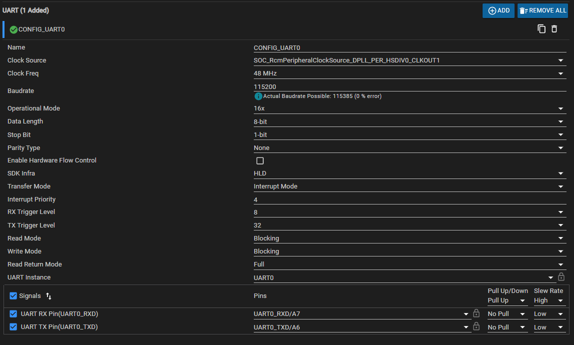

Serial cable is connected from our board to laptop using an isolater.  The bus is a bit noise and evident in seeing non ascii characters being echoed back and not all characters received at the MCU.  This can potentially cause bus errors.
When running in a live system after several hours, the UART RX on the MCU stops working but the TX is still working.  A thread is able to TX characters to the laptop.
MCU is unable to RX any commands which leaves the product in a very dangerous state since we can't shut it down.
As a first step, I asked AI to help find the issue.   I understand AI can hallucinate and gaslight, but it's response seems believable and highlighted some potential issues with the driver.
Can TI help confirm if this is indeed an issue with the driver or not?  This would really help focus my search on where this issue could reside.

  • Thanks for looking into this issue.  In terms of the questions:
    1. I've posted the complete UART sysconfig configurations in the original message.  Is there more that is needed?
    2. Have not had a chance to add monitoring code
    3. We have switched to polled mode and have not seen the issue.  But it was not easy to replicate in the first place, so not sure if not seeing is just coincidence.
    Any update on the analysis with the SDK team?

    On the SysConfig: Apologies for the confusion — you are correct that the configuration was included in the original post. No additional information is needed there.
    On Polled Mode Results: While the issue has not reappeared, we understand it was difficult to reproduce in the first place. We would recommend continuing to run in polled mode and monitoring over an extended period before drawing a firm conclusion. Given that your usage pattern (1-byte reads with a 10ms timeout) aligns naturally with polled mode semantics, this remains our recommended configuration regardless of the root cause.
