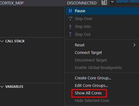

  • Hi RH,
    Let's try to narrow down what could be the issue. Can you try to connect the device core's with a project-less debug? Let me know what are the results:
    1. Right click in the projects' .ccxml file, and left click in Start Project-less Debug:
    2. Click in "Show All Core"
    3. Check which cores you are able to connect to
    Diego Abad
  • Hello Diego,
    1. This works. Mind you, I do have NRST connected to GND.
    3. CORTEX_M0P, CS_DAP_0 and SEC_AP show DISCONNECTED. No other cores appear.
    Kind Regards

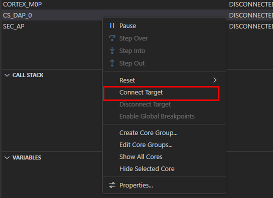

  • Hi RH,
    What happens when you right click in any of the cores and click connect? Do any cores shows an error?
    Diego Abad
  • All 3 report the same DAP Connection error. Which is why I assumed that either the device is in low power mode or that there is an issue with the bootloader/NONMAIN memory.
  • I have a different case now. I can connect to 2 of the cores but the factory reset yields no result, staying stuck at "Press the reset button".
  • Hi RH,
    What is the error that shows when you try to connect to the CORTEX_M0P?
    Diego Abad
  • Hello Diego,
    Error connecting to the target:  Connection to MSPM0 core failed.  Possible root causes: 1) Debug access within NONMAIN was disabled or enabled with password. 2) Peripheral mis-configuration (e.g improper watchdog or clock).  To see a more detailed diagnostic of the issue, please press the 'Read boot diagnostic' button.
    Best Regards
